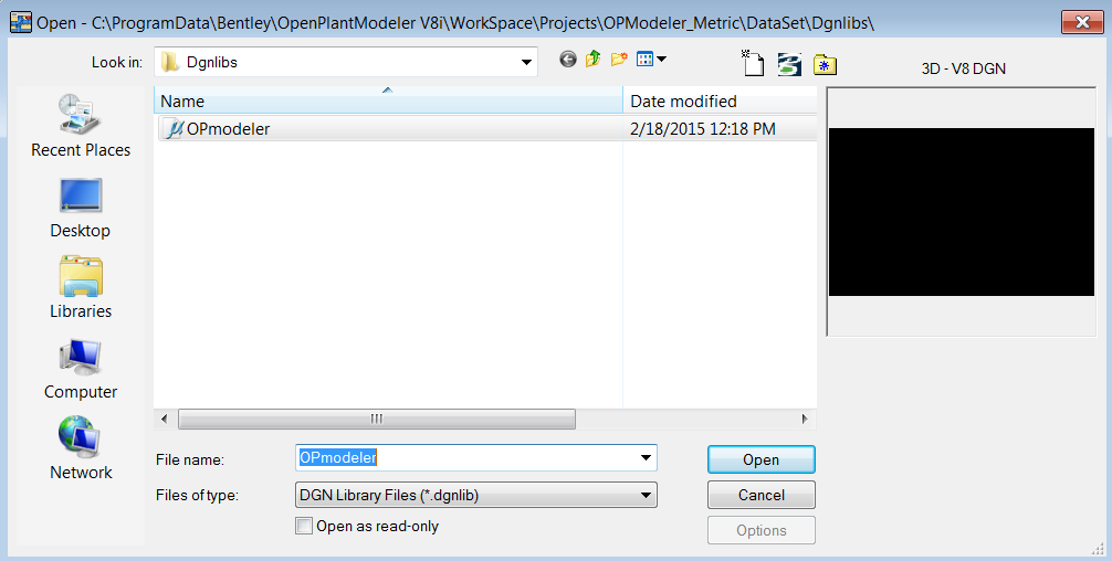

  1. Go to File from Main Menu option and open DGN library files (dgnlib). See image below :

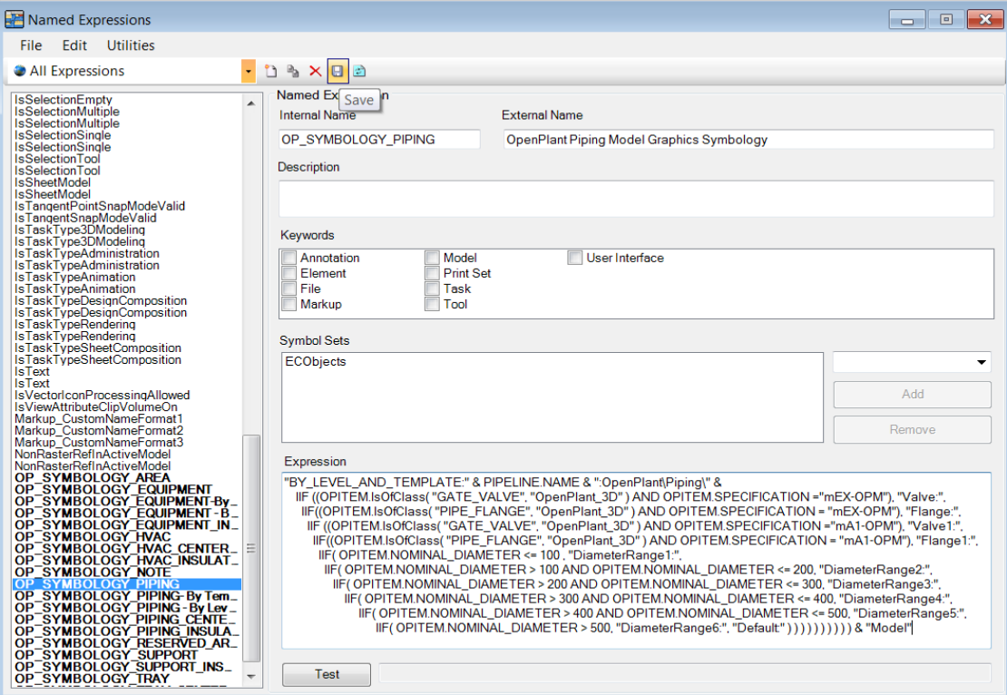

  2. Under Utility Menu, Select Named expression and click on OP_SYMBOLOGY_PIPING. See image below for reference.
  3. Similarly for OP_SYMBOLOGY expression for Centerline and Insulation is required. Below are the Symbology pasted to copy from here and to get it pasted to its respective Expression’s.
    OP_SYMBOLOGY_PIPING:

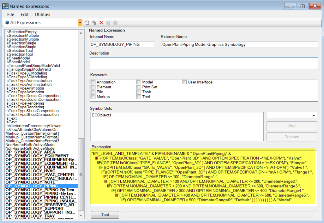

    Note: Make sure to copy the strings correctly.
  4. Save each Expression which turns blue. Save option will get enabled once you modify the Expressions: See below for reference.

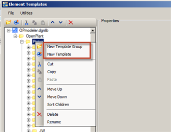

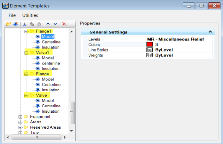

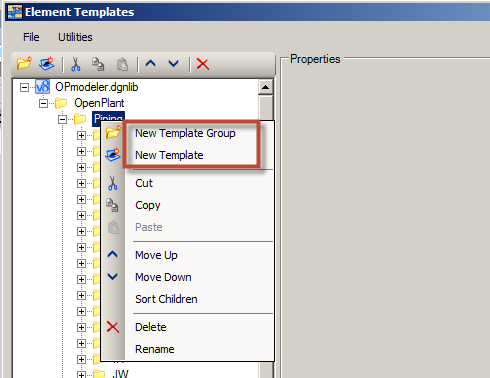

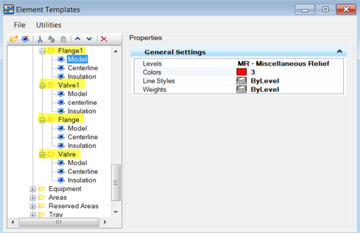

  5. Open Element Template, and Expand Piping Node. To define the components, say a Flange/Valve, user need to create a separate template group as shown below. Select ‘New Template group’ for a New Line Number and ‘New Template’ option to define 3 nodes Model, Centerline, and Insulation. See image below:
  6. Define component as shown in below for few pipelines.
    Note - Set colors as desired and levels where you want to define it by clicking on it. Similarly you can create it for centerline and Insulation.

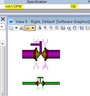

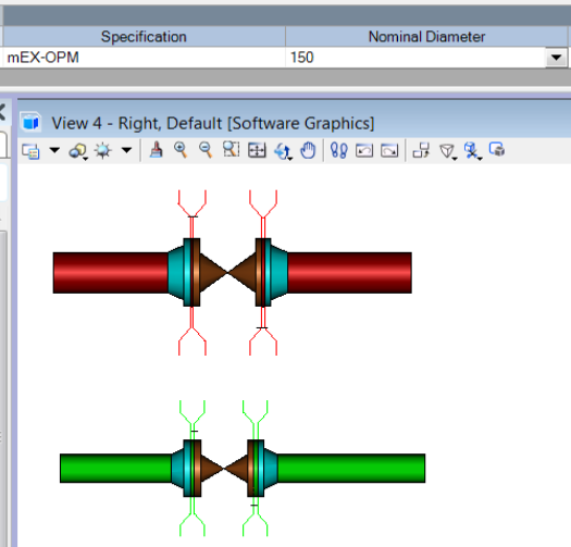

  7. Launch OpenPlant Modeler and Verify results. See images below:
    With Spec mEX-OPM
    With Spec mA1-OPM
