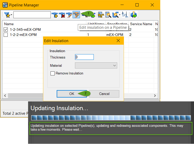

  1. Open Pipeline Manager, select the line(s) you would like to update, click Edit Insulation button;
  2. User may add a new insulation or may retain it to default setting and click OK. In both cases it redraw associated components. See below image of one example.
  3. After component update finishes, Edit the insulation again and check on the Remove Insulation to get inside pipeline to the original state.
  4. After these updates, pipeline should have a new Element Template applied to it, according to the changed Named Expressions. If pipeline already has some insulation, user would need to switch the order of steps 2-3, by firstly removing insulation, and then adding it back again.

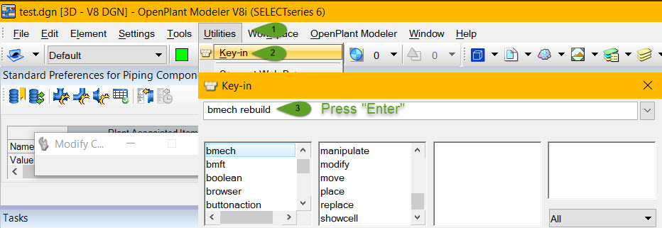

  5. Alternatively, user can select the pipeline and run Key-in "bmech rebuild". Save the DGN & it will restore the levels.
