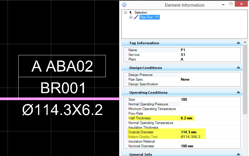

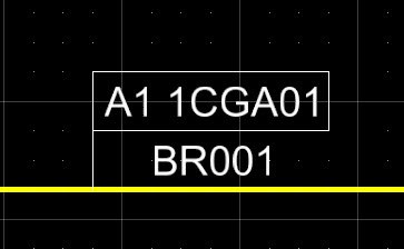

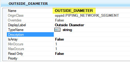

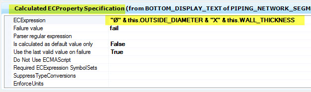

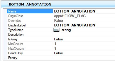

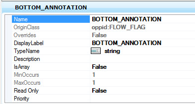

By default in KKS project, only two properties are annotated with flow flag as shown below.

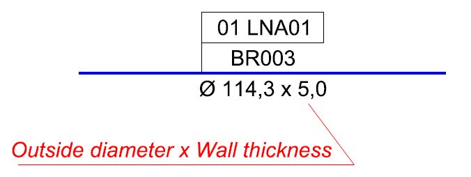

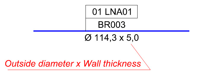

User's requirement is to show additional properties with flow flag as shown below.
