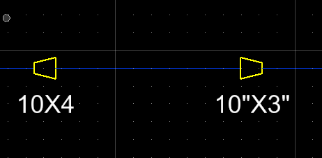

User wants to set annotation of reducer; first annotation always should be lager diameter of a pipe and second annotation should be smaller diameter independent of reducer direction.

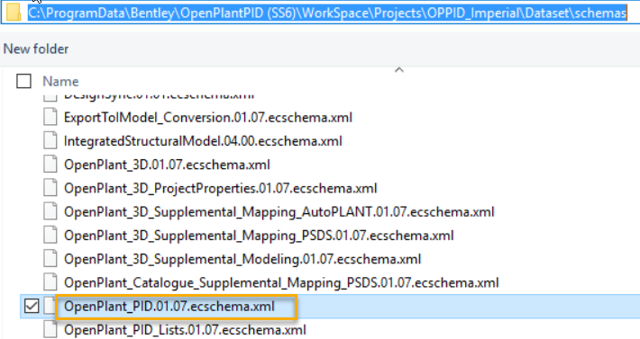

  2. Open OpenPlant_PID.01.07 schema.

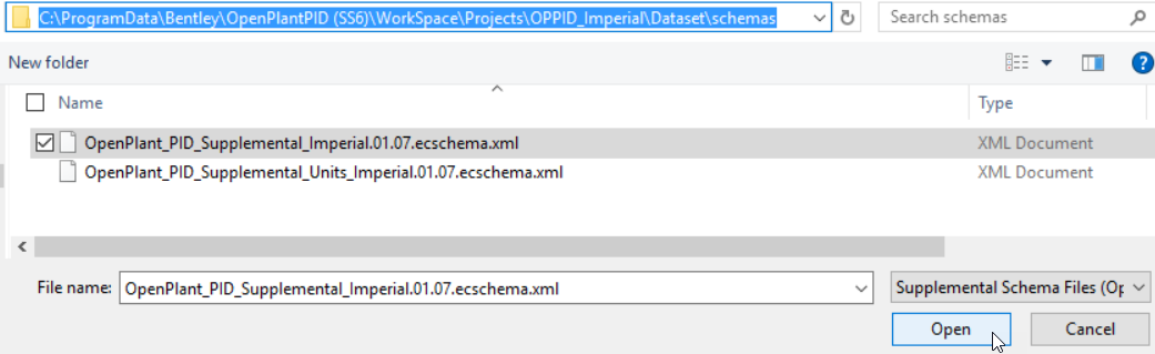

  3. Supplement with OpenPlant_PID_Supplemental_Imperial.01.07 schema.

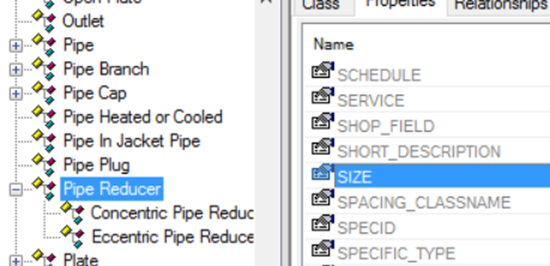

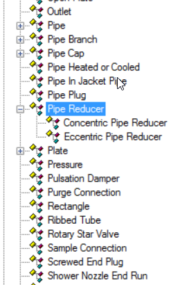

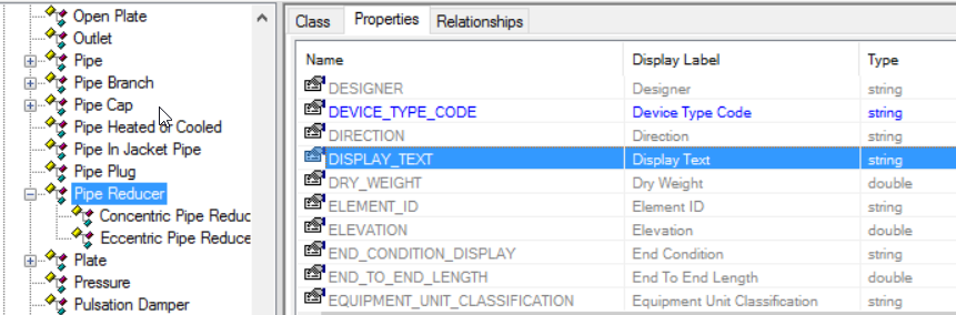

  4. Search for ‘Pipe Reducer’ Class.
  5. Switch to Properties tab and click on DISPLAY_TEXT custom attribute.

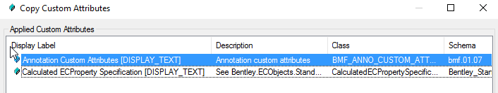

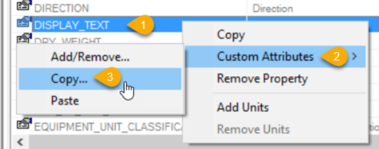

  6. Click on Override tab (by default it is grayed out).

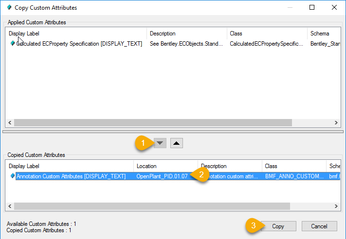

  7. Right click on DISPLAY_TEXT > Custom Attribute > Copy.

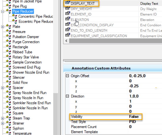

  8. Select Annotation Custom Attributes.
  9. In Annotation Custom Attribute Visibility set to False.

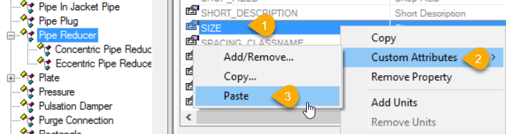

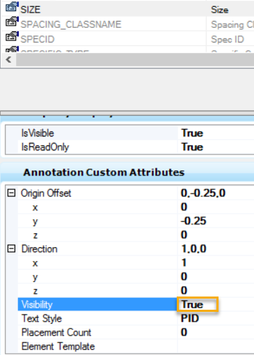

  10. Navigate to SIZE property.
  11. Right click on SIZE > Custom attribute > Paste.
  12. Save all settings.
  13. Open OpenPlant PID and Verify result.
