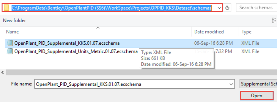

  1. Launch Bentley Class Editor.

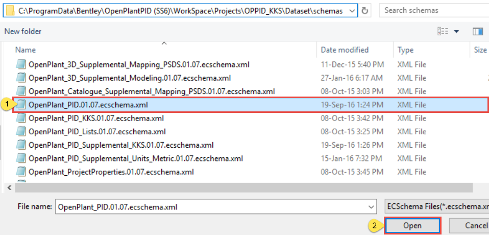

  2. Open OpenPlant_PID.01.07.ecschema.
    C:\ProgramData\Bentley\OpenPlantPID (SS6)\WorkSpace\Projects\OPPID_KKS\Dataset\schemas

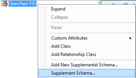

  3. Right click on OpenPlant PID from drop down select Supplement Schema.
  4. Supplement with OpenPlant_PID_Supplemental_KKS schema.
  5. Click Open.

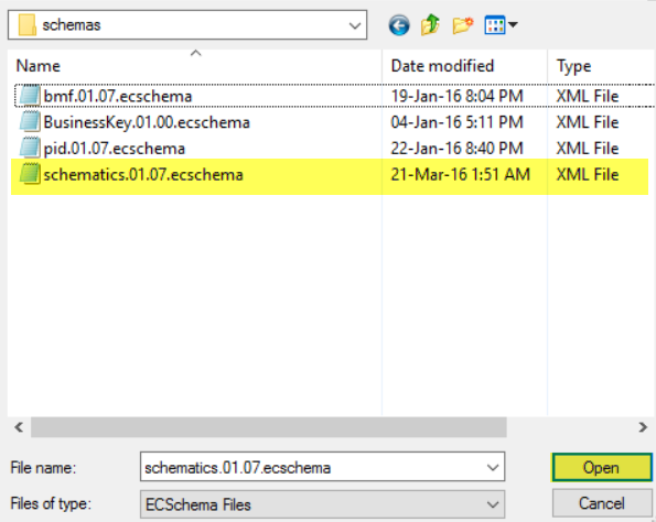

  6. Locate the missing reference schematics schema from following root.
    C:\Program Files (x86)\Bentley\OpenPlantPID (SS6)\OpenPlantPID\schemas
  7. Click on Open.

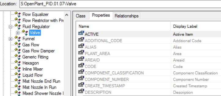

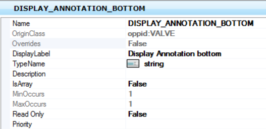

  8. Go to Valve class, switch to Properties tab.
  9. From right hand pane click on Add > New to add new property.

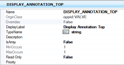

  10. Enter property name as DISPLAY_ANNOTATION_TOP as shown below.

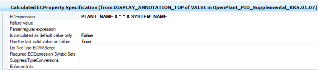

  11. Right Click on newly created property DISPLAY_ANNOTATION_TOP.

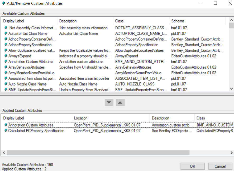

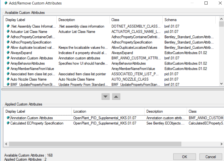

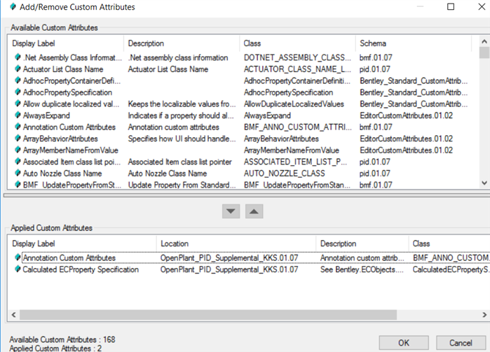

  12. Add custom attributes Annotation Custom Attribute & Calculated ECProperty Specification, change the location to OpenPlant_PID_Supplemental_KKS.

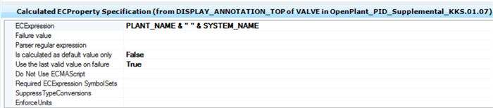

  13. In Calculated ECProperty Specification custom attribute tab enter the fields as shown.

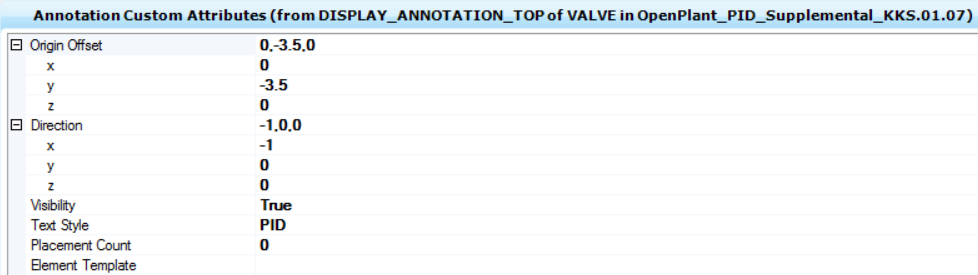

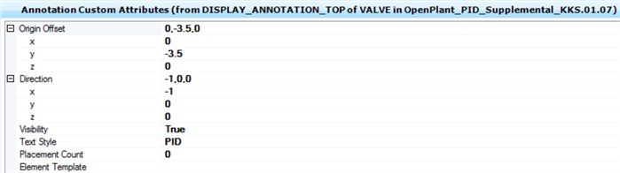

  14. In Annotation Custom Attribute Tab enter the fields as below.

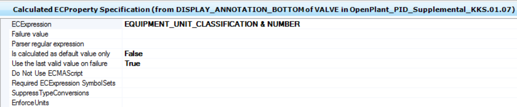

  15. Again, create a new property DISPLAY_ANNOTATION_BOTTOM.

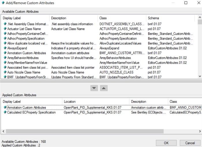

  16. Add custom attributes Annotation Custom Attribute & Calculated ECProperty Specification, change the location to OpenPlant_PID_Supplemental_KKS.
  17. Click OK
  18. In Calculated ECProperty Specification custom attribute tab enter the fields as shown.

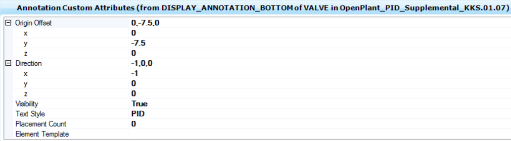

  19. In Annotation Custom Attribute Tab enter the fields as below.
  20. In Valve class under Properties tab search “NAME” property.
  21. Click on override to localize the property.

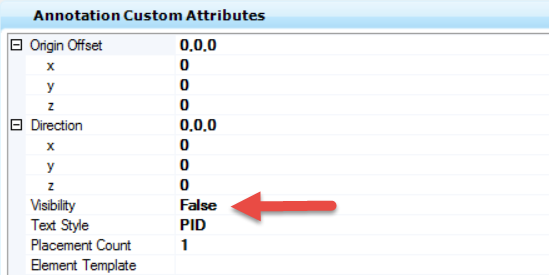

  22. Under Annotation Custom Attribute Tab change the setting as shown.
  23. Save all the changes.
  24. Launch OPPID place a valve and verify the result.
