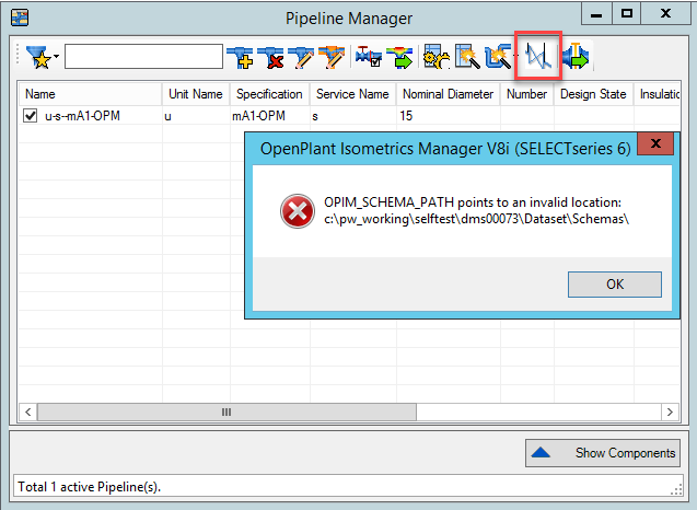

While working on OpenPlant Modeler version # 08.11.11.238 in Managed Environment, on trying to generate Isometrics In Session from Pipeline Manager the user gets the following error:

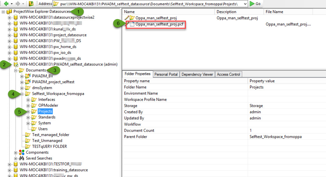

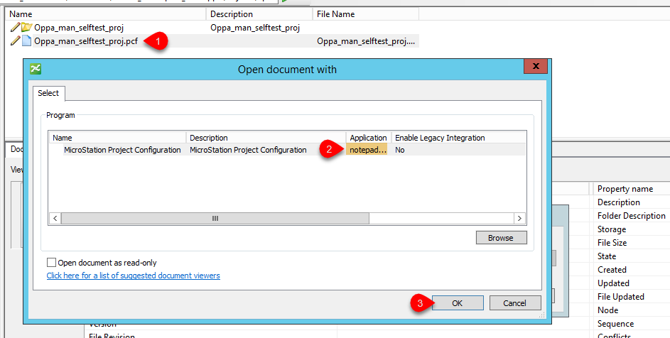

  1. Open ProjectWise Explorer and browse to your Managed Project
    ProjectWise Explorer Datasources -> Datasource_Name% -> %WorkSpace_Folder_Name% -> Projects -> %Project_Name%.pcf (.pcf file of the Project)
    Note: Our Datasource Name is PWADM_selftest_dadasource; WorkSpace Name is Selftest_Workspace_fromoppa; Project Name is Oppa_man_selftest_proj

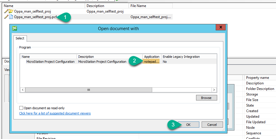

  2. Double click the pcf file; Make sure the Application selected is Notepad, if not select browse and select Notepad; Click Ok

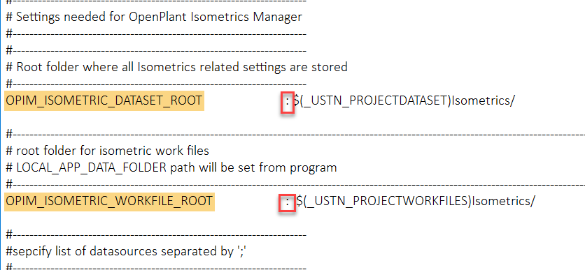

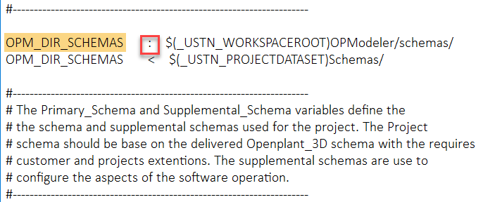

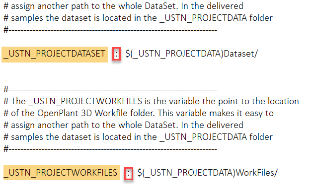

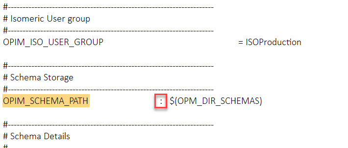

  3. In the file that opens, for the following variables change ‘=’ to ‘ : ‘ i.e. Equal to is changed to a colon

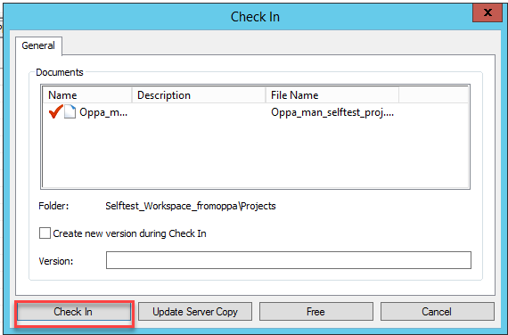

  4. Close the notepad file and click Check In
