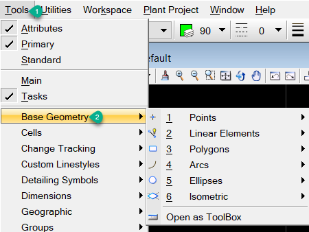

  2. To Create Custom Graphics, go to Tools &  Base Geometry Tool.
  3. Create graphics and select by using element selection tool

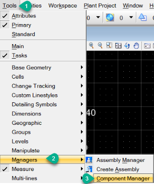

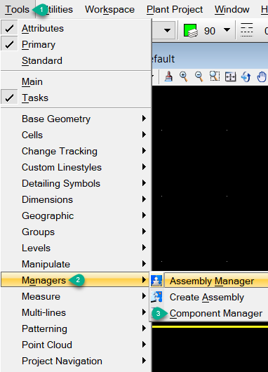

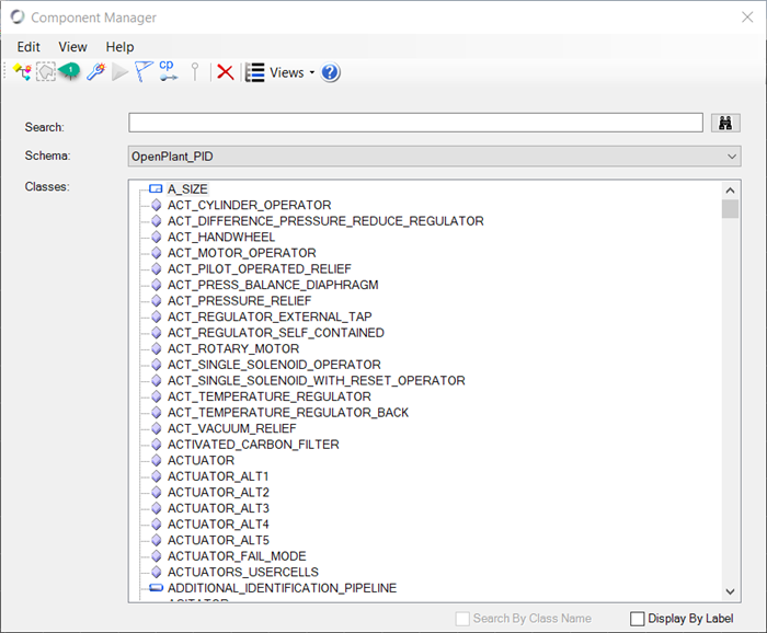

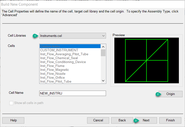

  4. Go to Tools > Managers > Click on Component Manager
  5. Click on "Create Component from Elements"

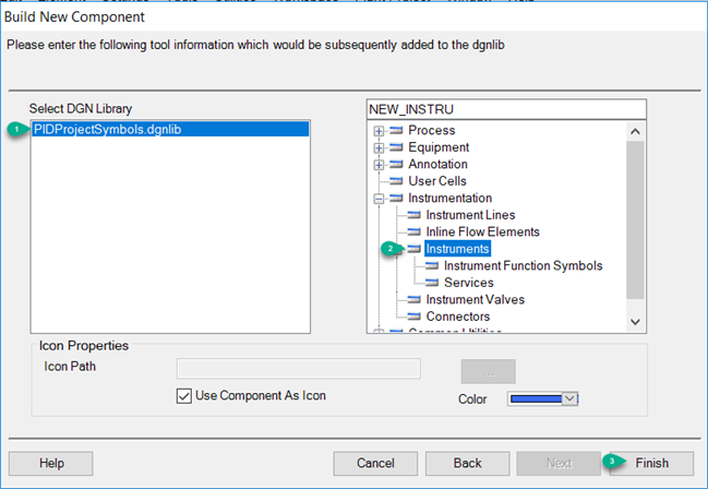

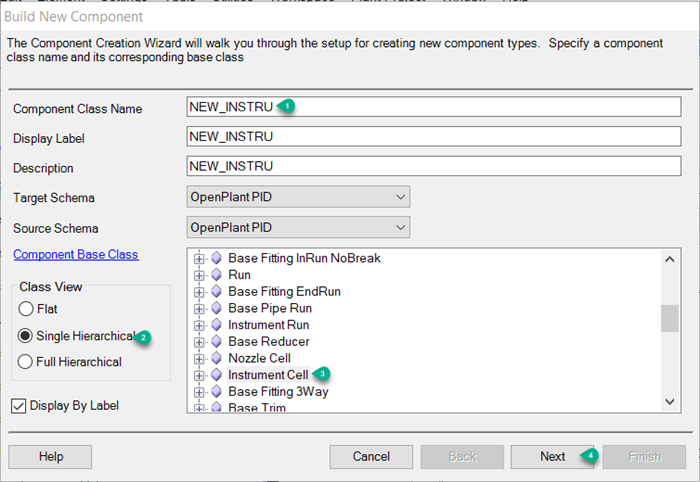

  6.  Build New Component Wizard will pop up.
  7. Select specific cell library here, Instrument.cel, define origin and click “Next”
  8. Click “Next”

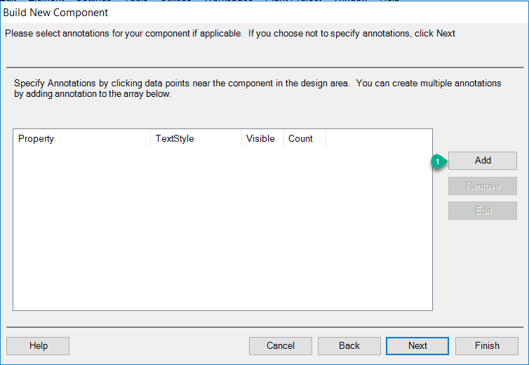

  9. 'Add Annotation', Placement count for the property and Click Ok
  10. Click 'Next'
  11. Click 'Finish'

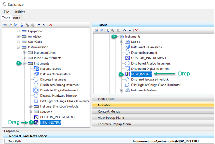

  12. Customize dialog will pop up.

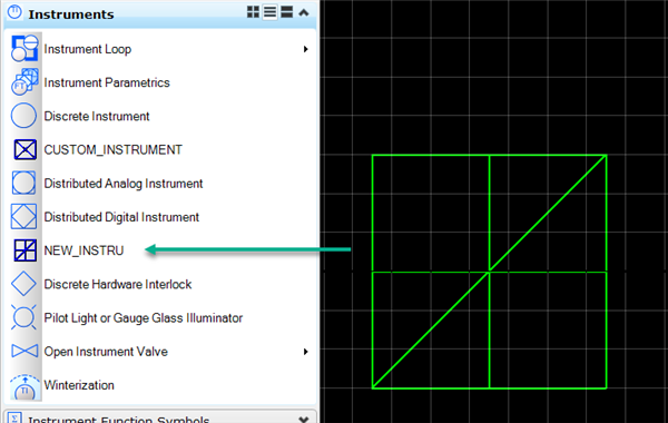

  13. Now, Drag and Drop Custom Instrument from Left user task bar to Right user task bar

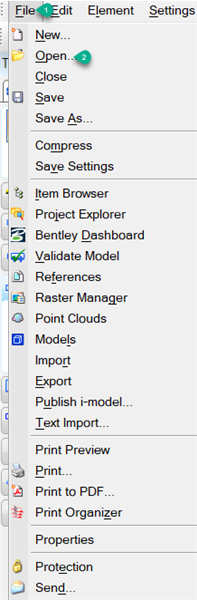

  14. Close above dialog box and Go to File > Open
  15. Notice below result of a Customized instrument

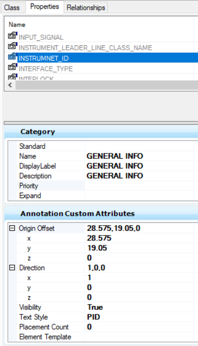

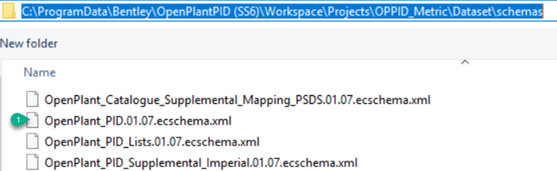

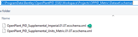

  1. Launch Class editor.
  2. Load OpenPlant_PID.01.07.ecschema and supplement with OpenPlant_PID_Supplemental_Imperial.01.07.ecschema

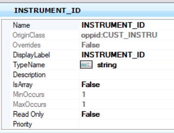

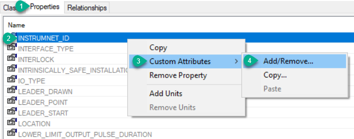

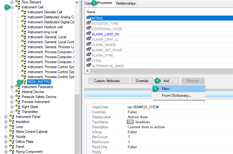

  3. Navigate to NEW_INSTRU , switch to properties tab, click on Add > New.
  4. Fill below details.
  5. Right Click on INSTRUMENT_ID, Add new custom attributes 'Category' and Annotation Custom Attribute', Click Down arrow, change location to OpenPlant_PID_Supplemental_Imperial.01.07. See below images.
  6. Save all the changes.

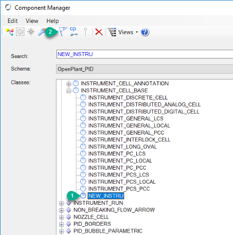

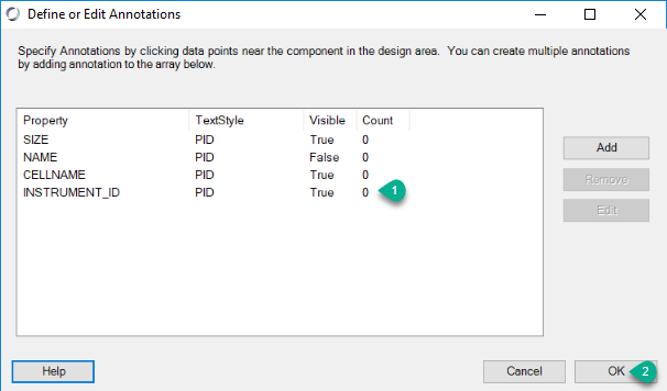

  7. Launch OPPID, go to Tools > Managers > Component manager > Search CUST_INSTRU & Click on 'Define or Edit Annotations'

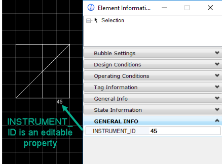

  8. Place NEW_INSTRU and verify below result.
    Note: Similarly, you can place different annotations for different properties.
