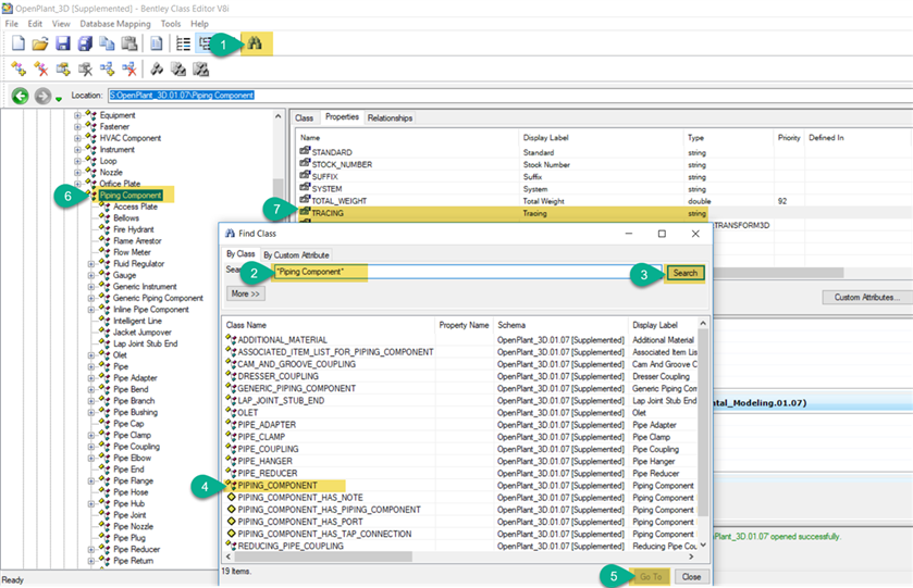

  1. Launch Class Editor, and open the OpenPlant_3D.01.07.ecschema.xml schema.
  2. Supplement Main Schema with Supplemental Schemas, follow below WIKI for supplementing Schema. Click in Below link to get Schema Supplementing information.
    Click Here >>>>>
  3. Now search for *Piping Component* and follow below steps.

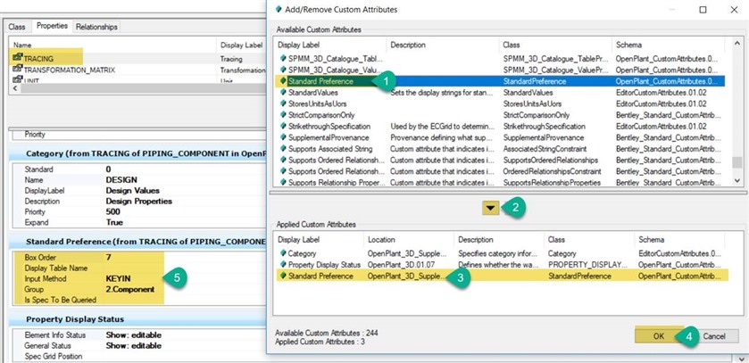

  4. Switch to Property Tab and Add Standard Preference Custom Attributes as shown below.
    Fill the details as below and do a save to Schema.
    Box order: 7
    Input Method: KEYIN
    Group: 2.Component

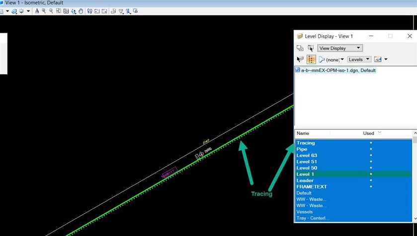

  5. Now Launch OpenPlant Modeler and verify the result by creating new pipeline with tracing value as 1 and Generating Isometric.
    In Standard Preference we need to set value as 1, which means tracing has set to ON. If it is 0 then OFF.
