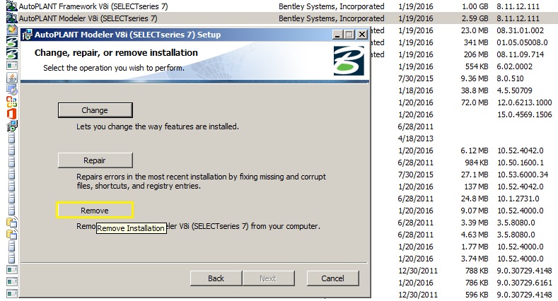

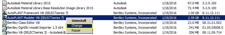

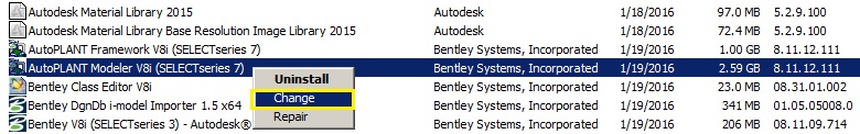

  1. From the Add\Remove Programs right-click AutoPLANT Modeler and select "Change",
    and then it can be removed using AutoPLANT Modeler installation application.

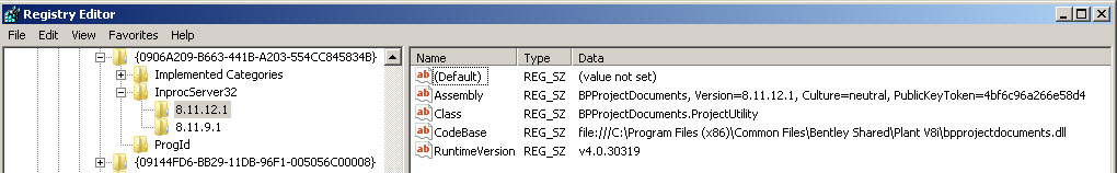

  7. After uninstalling any AutoPLANT version it is recommended to check registry entries for some leftovers.
  8. For this purpose it will be much easier if required version registry cleaning file will be used. Below are possible registry cleaning tools:
    remove SS3 reg.reg.txt
    remove SS4 reg.reg.txt
    remove SS5 reg.reg.txt
    remove SS6 reg.reg.txt
    remove SS7 reg.reg.txt
    Download required version, remove "*.txt" ending and double-click.

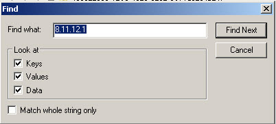

  9. After using required registry cleaning tool check one more time if registries are cleaned correctly. Select Edit>Find, search for required version entries and remove if some leftovers will be found.
