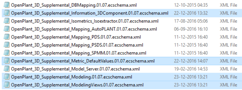

  1. Launch Bentley Class Editor,Open OpenPlant_3D.01.07. ecschema.
  2. Supplement with below highlighted schema as shown.
    Path: C:\ProgramData\Bentley\OpenPlantModelerV8i\WorkSpace\Projects\OPModeler_Metric\DataSet\Schemas
     For More information on supplementing schemas click here>>>>

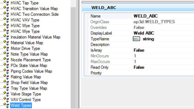

  3. Navigate to Weld Types class, switch to Properties tab.

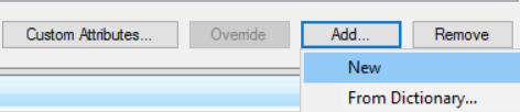

  4. Click on Add... to add a new type of weld type property.
  5. For new weld type enter the details as shown below.

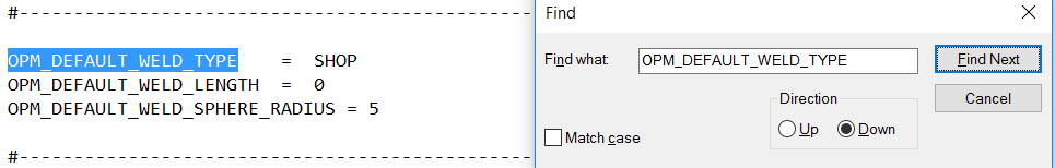

  7. Navigate to below mentioned root, open OPModeler_Metric.pcf to edit.
    Default Path: C:\ProgramData\Bentley\OpenPlantModeler V8i\WorkSpace\Projects
  8. Search for variable OPM_DEFAULT_WELD_TYPE as shown below.

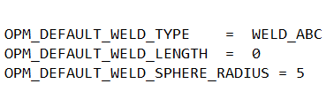

  9. Change weld type as WELD_ABC as shown below.

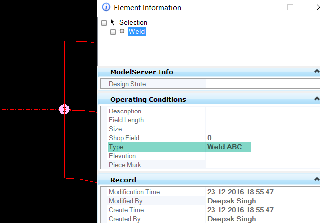

  10. Save all the settings & verify the result as shown below.
