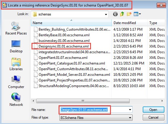

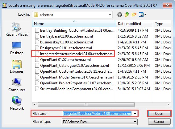

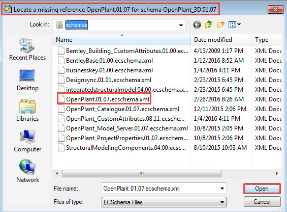

  1. Launch Bentley Class Editor.

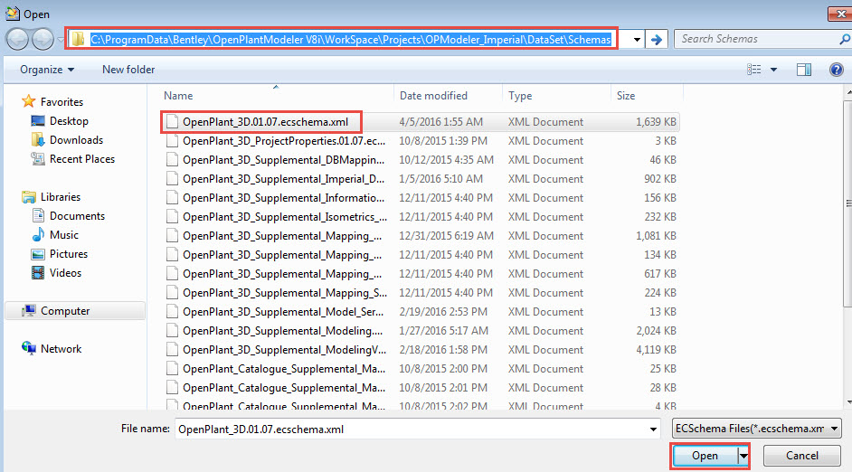

  2. Open “OpenPlant_3D.01.07.ecschema.xml” schema say for “OPModeler_Imperial” from workspace project schema folder.
    “C:\ProgramData\Bentley\OpenPlantModeler V8i\WorkSpace\Projects\Project Name\DataSet\Schemas”

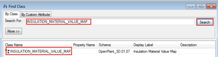

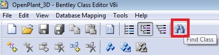

  3. Once schema is loaded, select “Find Class” in Class Editor.

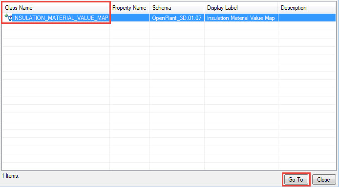

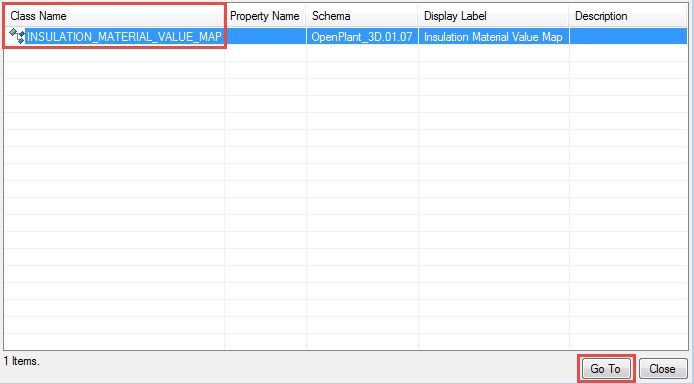

  4. Search for “INSULATION_MATERIAL_VALUE_MAP”.
  5. Select the “INSULATION_MATERIAL_VALUE_MAP” class name and press “Go to “

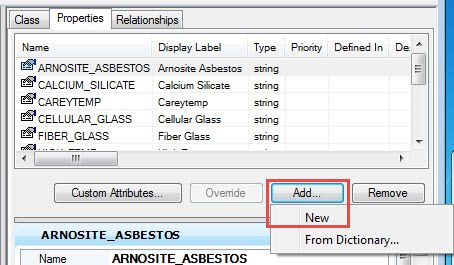

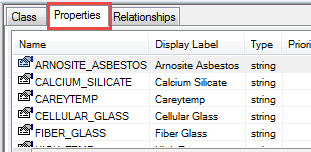

  6. Go to “Properties” tab.

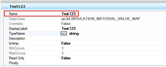

  7. Press “Add…” –-> New to add new property.
  8. Define the Name of new Insulation.
  9. Save the changes.

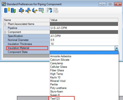

  11. Now launch OpenPlant Modeler in same units in which changes were made (OPModeler_Imperial in this case).
  12. New Insulation material must be included in “Standard Preferences” Insulation Material drop down list.
