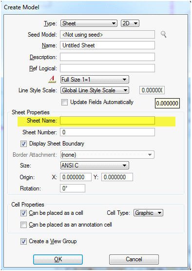

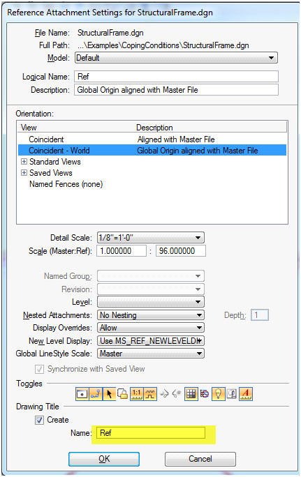

The fields in the Drawing Title cell are populated when a reference is attached to a sheet model.
In the Drawing Title bubble the sheet name comes from the Sheet Name field of the Create Model dialog box. You would have used this to create a new sheet. The drawing number is automatically generated based on the number of reference attachments on the sheet.
The Drawing and Scale fields come from the Reference Attachment Settings dialog box.
