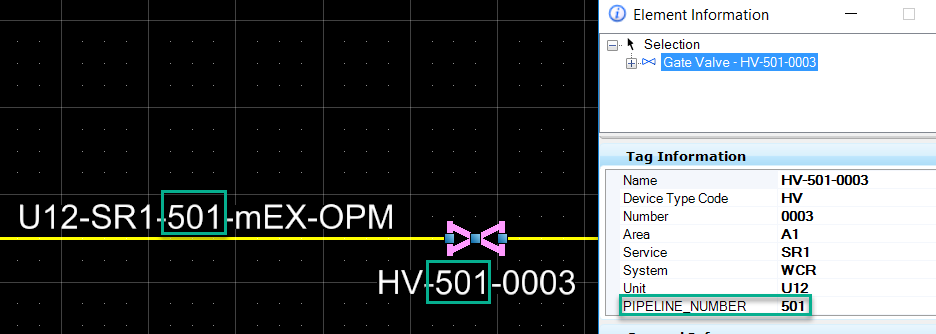

This article will cover how user can bring pipeline number on a valve class and use that in Valve Tag. For this example we will create a property PIPELINE_NUMBER for example.

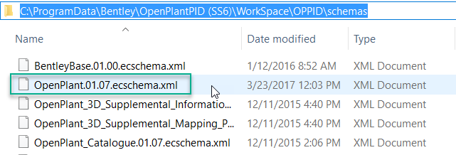

  2. Open OpenPlant.01.07schema.
    Path: C:\ProgramData\Bentley\OpenPlantPID(SS6)\WorkSpace\OPPID\Schemas
  3. Supplement OpenPlant.01.07 schema with OpenPlant_Supplemental_Tagging.01.07 Schema.

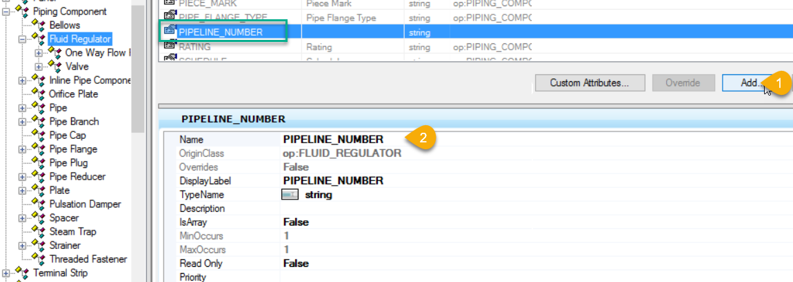

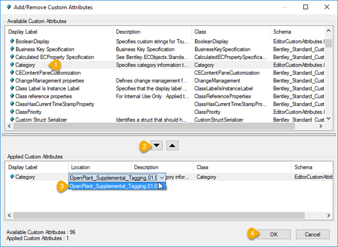

  4. Expand Piping component class, navigate to Fluid Regulator. Add new property as ‘PIPELINE_NUMBER’ and fill details as below.

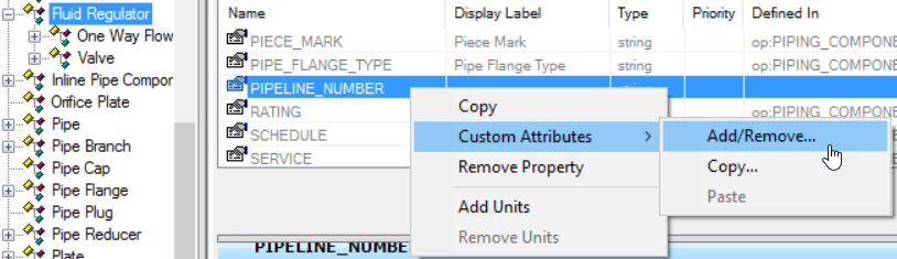

  5. Add ‘Category’ custom Attribute to PIPELINE_NUMBER property.

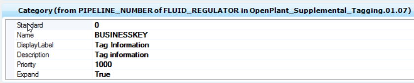

  6. Enter details in Category as shown below.

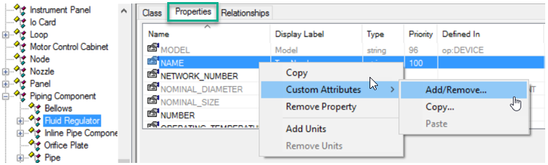

  7. Switch to Properties tab and select Add/Remove to add Custom Attribute on NAME property as shown below.

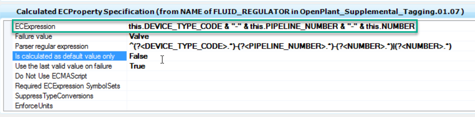

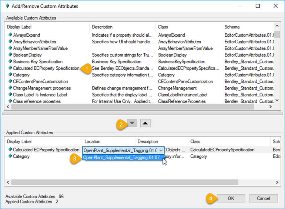

  8. Add “Calculated ECProperty Specification” custom attribute on NAME Property.
  9. Change the Expressions as given below.
    ECExpression :    this. DEVICE_TYPE_CODE & “-“ & this.PIPELINE_NUMBER & “-“ & this.NUMBER
    Parser regular expression : ^(?<DEVICE_TYPE_CODE>.*)-(?<PIPELINE_NUMBER>.*)-(?<NUMBER>.*)|(?<NUMBER>.*)

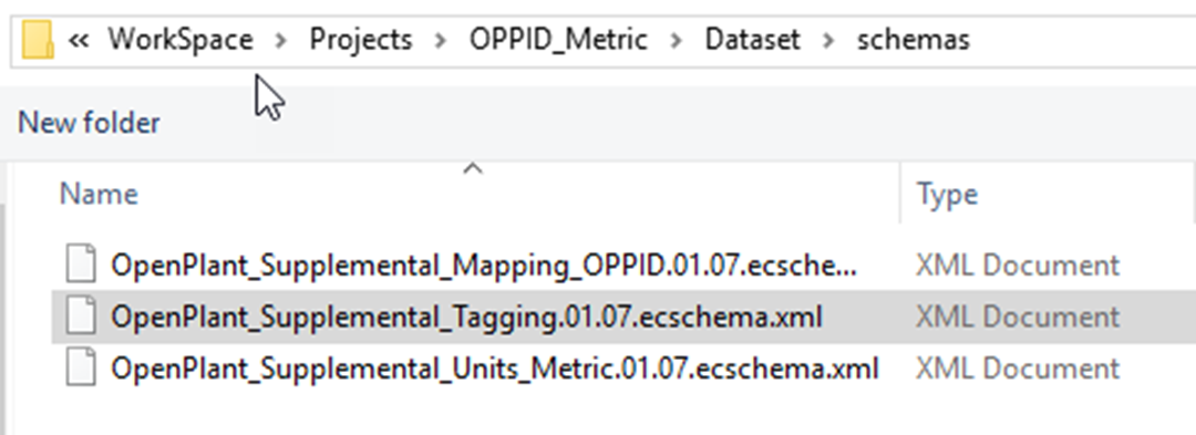

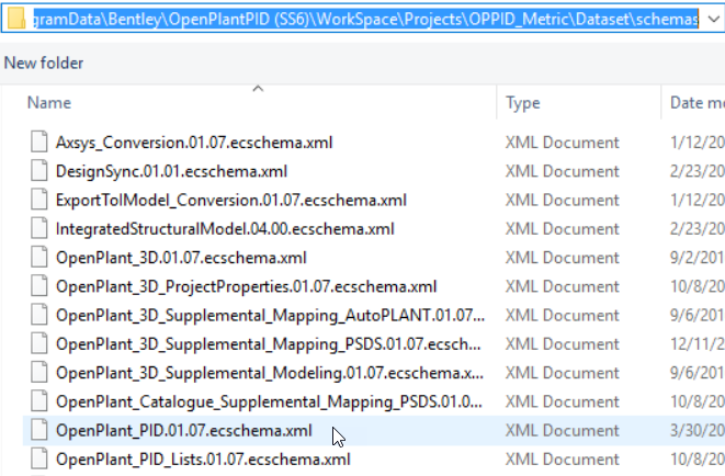

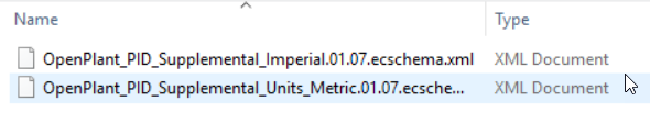

  11. Open OpenPlant_PID.01.07 of desired project, say here Metric.
  12. Supplement it with OpenPlant_PID_Supplemental_Imperial.01.07 schema as shown below.

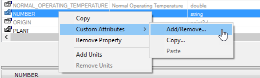

  13. Navigate to Pipeline Class and select NUMBER property.

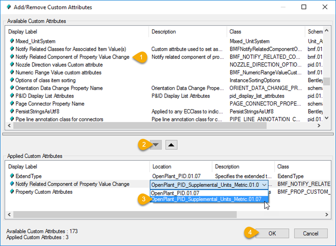

  14. Right Click the NUMBER property. Select Custom Attribute> Add/Remove.

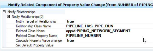

  15. Add Notify Related Component of Property Value Change on NUMBER property as shown below.
  16. Key-in the values in respective fields as shown below

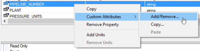

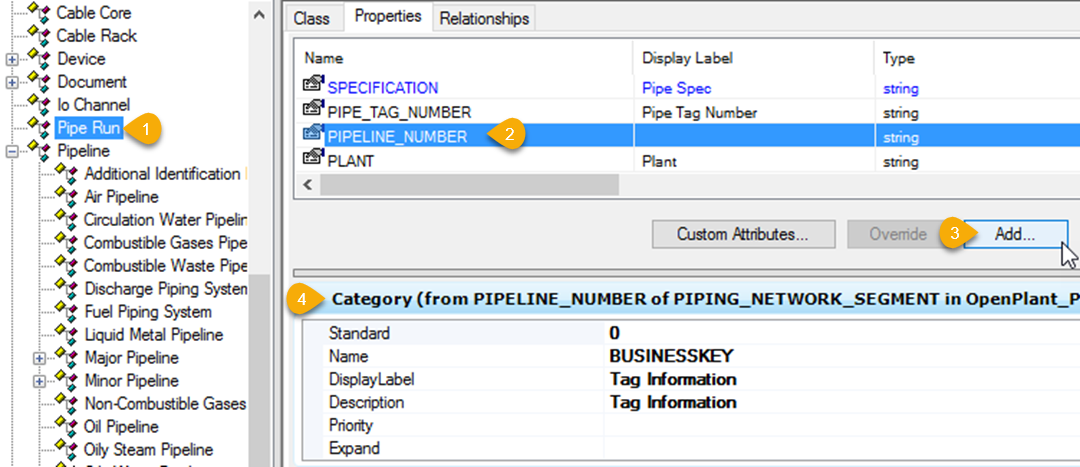

  17. Switch to PIPE RUN class and Add PIPELINE_NUMBER property

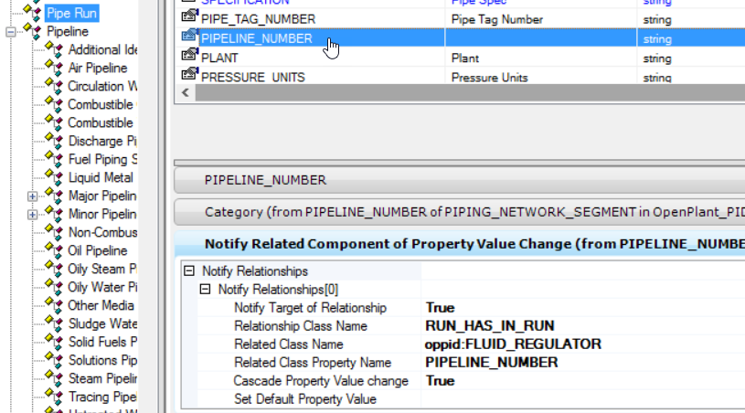

  18. Add Notify Related Component of Property Value Change” custom attribute to PIPELINE_NUMBER property
  19. Key-in the values in respective fields as shown below.
  20. Save all the settings and check result.
