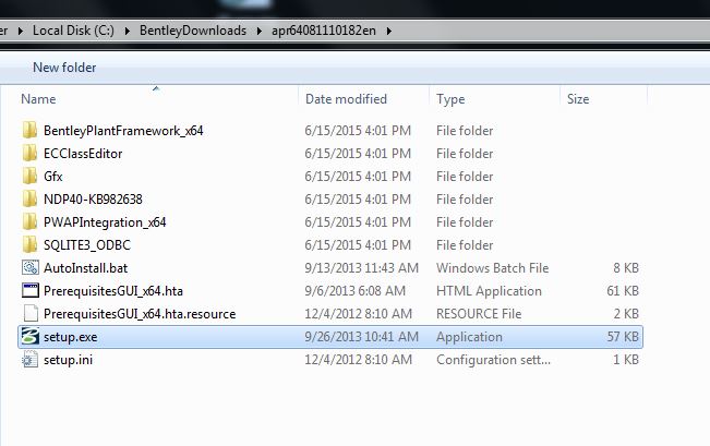

For Plant applications to install and sync with ProjectWise has always required the ProjectWise client applications to be installed first. That is before any Bentley plant application is installed on the workstation. However, as installations are not always perfect.
In the past the users would have to uninstall all Bentley Plant applications and ProjectWise (if corrupt).

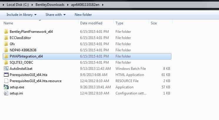

A new tool has been created that when ran installs the ProjectWise files that are required. This prevents the users from the need to totally uninstalling all Bentley Plant applications and ProjectWise and starting again from new. This tools will save time in this situation. Once the tool is ran and the files are installed the only requirement is that the Bentley Plant applications and Bentley Plant Framework are repaired from the Setup.exe. Please refer to the steps below for a complete description:
Finding and Installing the PWAPIntegration Tool.
