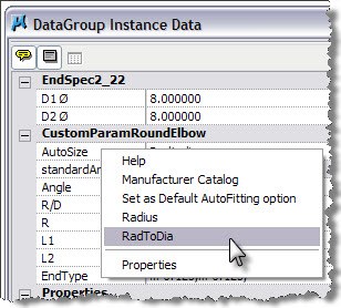

  3. In the DataGroup Instance Data dialog, right-click on the word "AutoSize"
  4. Choose one of these options:
    1. Radius:  This will draw all the auto-fitting elbows at the current fixed radius regardless of the pipe diameter.  (never a good choice when placing plumbing)
    2. RadToDiam:  This will set the radius of each auto-fitting elbow based on the a fixed R/D ratio and the diameter of the duct.
  5. Set the R/D Ratio to what you want.  (1.0 for short radius elbows; 1.5 for standard or long radius/ sweep elbows)
  6. Right-click again on the word "AutoSize" and choose "Set as Default AutoFitting Option"
    1. Radius:  This will draw all the auto-fitting elbows at the current fixed radius regardless of the duct diameter.  (not always a great choice)
  5. Set the R/D Ratio to what you want.  (.5, .75, 1.0, 1.5, 2.0 are common choices in the US)

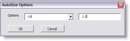

  4. Choose AutoSize Options to open the AutoSize options dialog.
  5. In the pick list choose an option:
    1. inradius:  This will draw all the inside radius of the auto-fitting elbows at the current fixed radius in field R1.  The outside radius will be R1 + W1 or R1 + D1 depending on the direction of the elbow.
    2. r/d = <value>:  This will set the centerline radius of each autofitting elbow equal to Depth1 (D1) x <value>.
