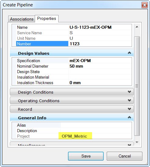

This article will provide the steps to populate project name on an EC Property which can be further used to include in pipeline, iso-sheet tagging. In this example, we will add this information on a property in PIPING_NETWORK_SYSTEM class.

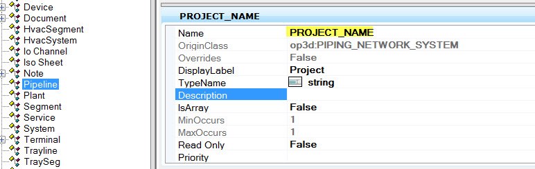

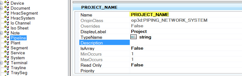

  1. Launch Class Editor and load OpenPlant_3D schema from your project.
  2. Supplement it with OpenPlant_3D_Suppelmental_Modeling and OpenPlant_3D_Suppelmental_Modeling_Views schema.
  3. Go to PIPING_NETWORK_SYSTEM class and add new property "PROJECT_NAME".

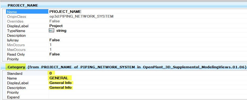

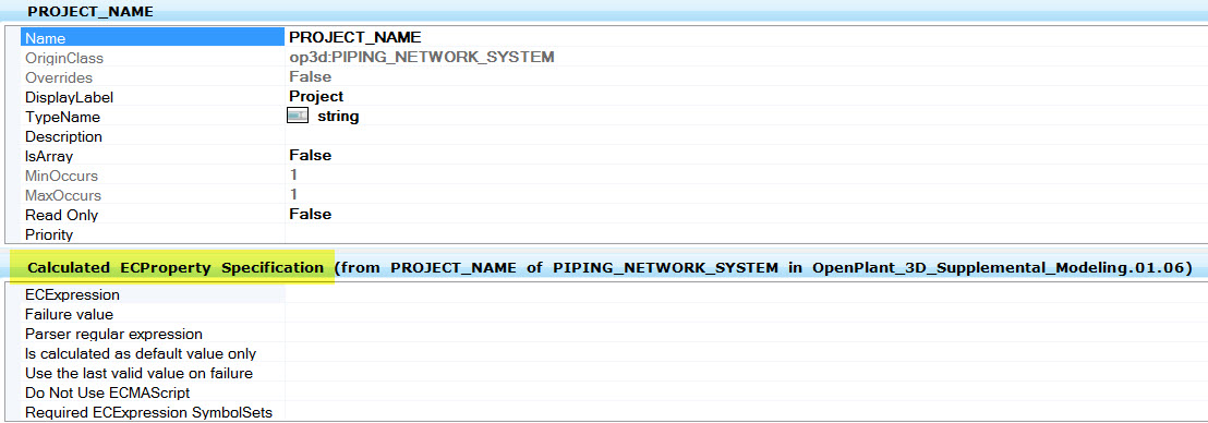

  4. Add a Category custom attribute and add the values as highlighted below:

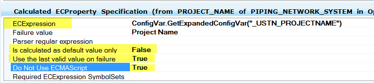

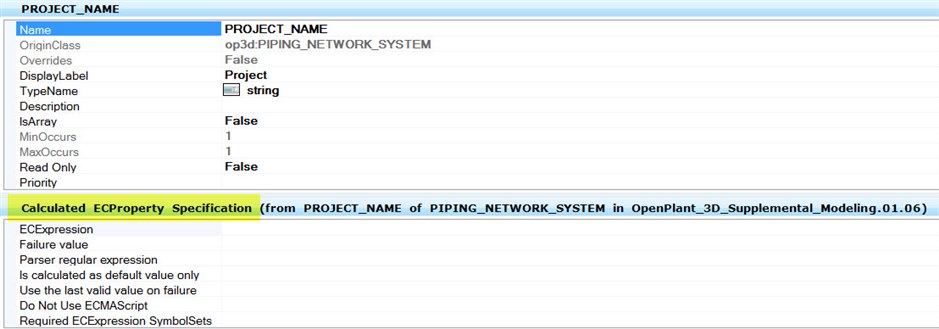

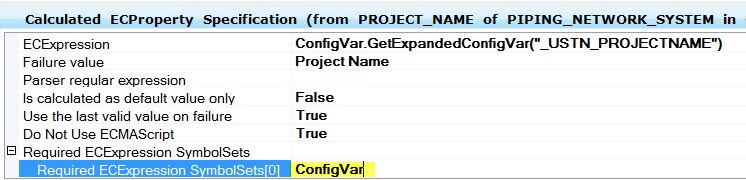

  5. Add another custom attribute 'Calculated ECProperty Specification'.
  6. Add below expression in EC Expression field and set the highlighted fields as shown below.
    ConfigVar.GetExpandedConfigVar("_USTN_PROJECTNAME")

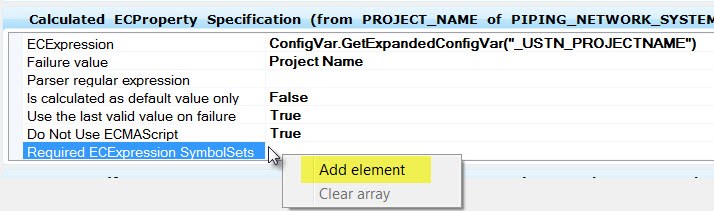

  7. Right click on 'Right ECExpression SymbolSets' field and click 'Add element'.
  8. Add 'ConfigVar' in the field as highlighted below.
  9. Save the changes in schema and verify results in OpenPlant Modeler.
