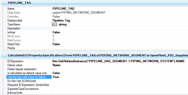

  3. Go to PIPING_NETWORK_SEGMENT (Pipe Run) class and add a new property PIPELINE_TAG.
  4. Add "Calculated ECProperty Specification" custom attribute on it and add below EC Expression.
    this.GetRelatedInstance("PIPELINE_HAS_SEGMENT:1:PIPING_NETWORK_SYSTEM").NAME

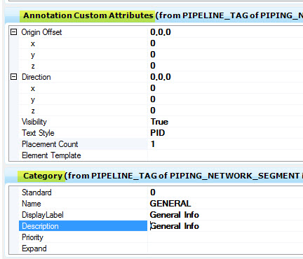

  5. Add Category and Annotation Custom attribute as well on this property.

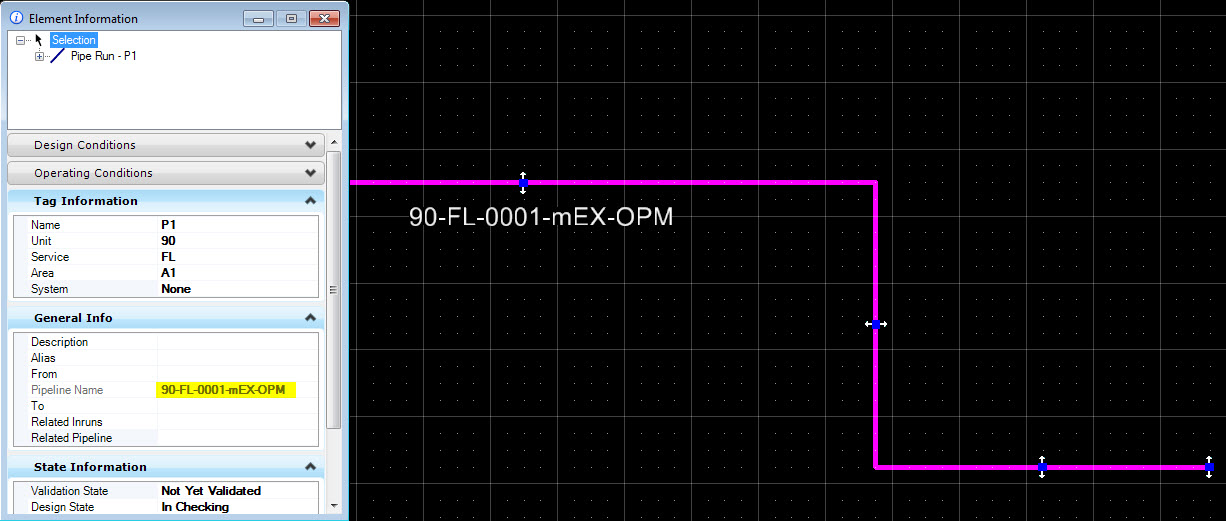

  1. Launch OpenPlant PID and open a drawing.
  2. Create a pipeline and place it on the drawing. As soon as the pipe run is placed annotation is linked to cursor, place the annotation.

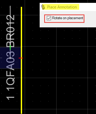

  3. Place a major pipeline in vertical direction, in Place Annotation window check for Rotate on placement.
  4. Define a origin point to place the annotation and rotate as desired.
