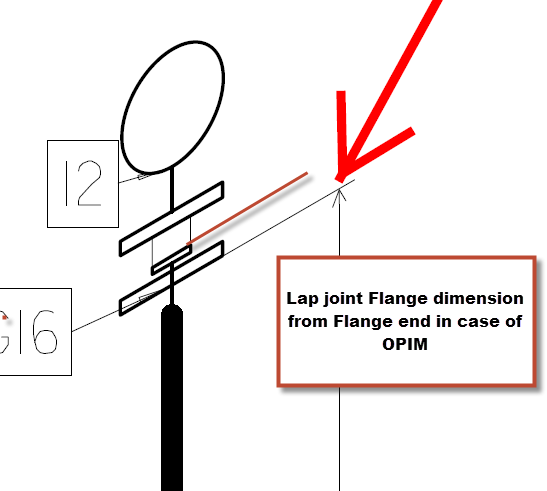

Dimension Stub End:

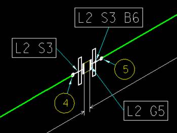

By default the lap joint stub end component dimension at its flange end part. See image below:
To Dimension Lap Joint stub end from End point below is the customization which is required:

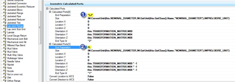

- In class editor, open OpenPlant_3D_Supplemental_Isometrics_Isoextractor.01.04 schema (%ProjectRoot%...Bentley\OpenPlantModeler V8i\WorkSpace\ Projects\OPModeler_Metric\ DataSet\Schemas\)
Note: Above path location mentioned for default out of the box installation.
- Search Class “Lap Joint Flange”.

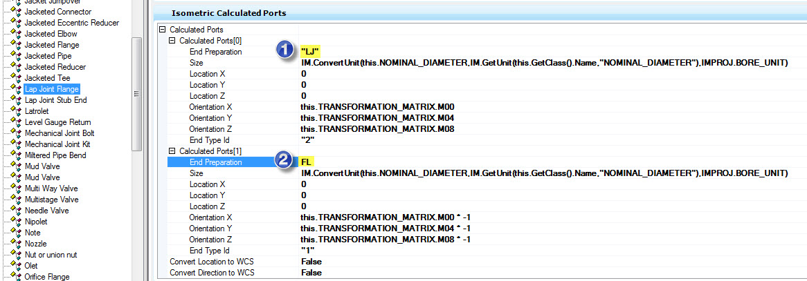

- Change the mapping for the lap joint end preps as follows:
- Change Calculated Port[0] > End Preparation from “IF” to “LJ”
- Change Calculated Port[1] > End Preparation from “IF” to “FL”.
See image below for reference
4. Save Schema and generate isometrics. It will dimension it from stub end. See images below:
