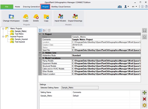

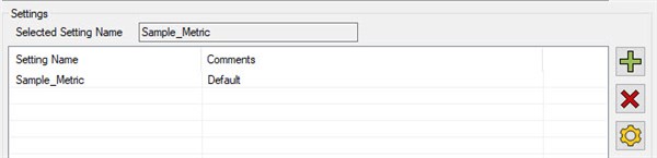

  1. Launch OpenPlant Orthographics Manager CONNECT Edition and select a project
  2. Go to Project tab
  3. Settings details will be shown on “Project” page

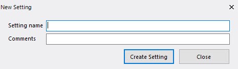

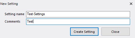

  4. Press “+” button to Add a new setting
  5. New Setting dialog will pop up
  6. Give Setting name and Comment if any , and press “Create Setting”

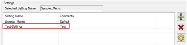

  7. New Settings will be Created and list down

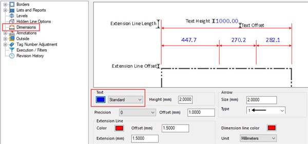

  8. Select the newly created Settings and press Configure Settings button

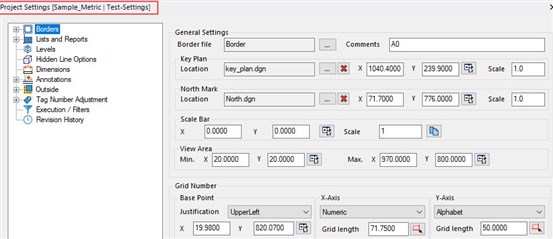

  9. Settings dialog will pop up mentioning the Project name and Settings Name on Top left
  10. Go to any Settings and make some changes say “Dimensions” and change Text color to “Blue” from Yellow
  11. Press Save button and close Settings Dialog

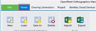

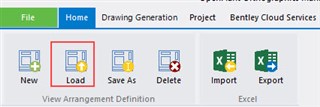

  12. Now go to “Home” tab
  13. Press “Load” button

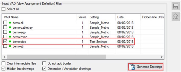

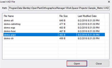

  14. Load VAD File dialog will pop up
  15. Select a VAD file for which you want to change settings and press “Open” button

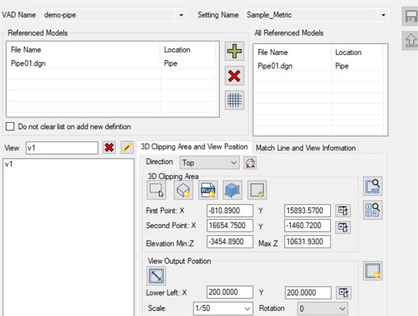

  16. Selected VAD will be loaded
  17. Go to Setting Name drop and select the required Setting for a specific VAD file
  18. Press “Save” button

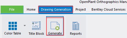

  19. Go to Drawing Generation -- > Generate
  20. Setting name will be updated as per selected setting in Input VAD list
  21. Select the VAD file and press “Generate Drawings”
  22. Output will be generated as per new settings
