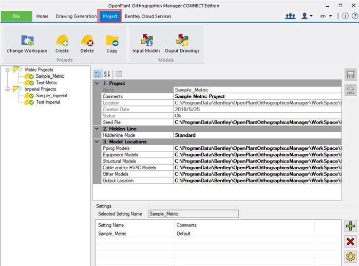

  1. Launch OpenPlant Orthographics Manager CONNECT Edition and select a project
  2. Go to Project tab

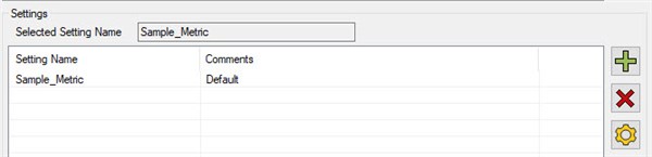

  3. Settings details will be shown on “Project” page

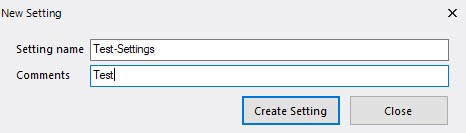

  4. Press “+” button to Add a new setting
  5. New Setting dialog will pop up

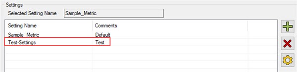

  6. Give Setting name and Comment if any , and press “Create Setting”
  7. New Settings will be Created and list down
