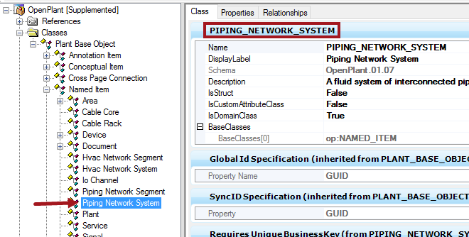

Steps To Accomplish
  1. Launch class editor and load OpenPlant.01.07 schema. This schema is generally located in C:\ProgramData\Bentley\OpenPlantPID (SS6)\WorkSpace\OPPID\schemas folder.
  2. Supplement it with OpenPlant_Supplemental_Tagging schema. This is a project specific schema and generally located in C:\ProgramData\Bentley\OpenPlantPID (SS6)\WorkSpace\Projects\OPPID_Metric\Dataset\schemas folder.

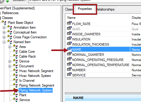

  3. Locate the class for which you want to modify the tag format. For example, PIPING_NETWORK_SYSTEM.
  4. Switch to properties tab and select NAME property.

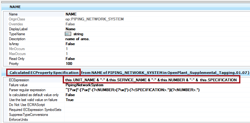

  5. Tag format is defined in the form of EC expression and Parser Expression as shown below in Calculated ECProperty Specification custom attribute.
ECExpression
this.UNIT_NAME & "-" & this.SERVICE_NAME & "-" & this.NUMBER & "-" &  this.SPECIFICATION
ParserRegularExpression
^[?\w]*-[?\w]*-(?<NUMBER>[?\w]*)-(?<SPECIFICATION>.*)|(?<NUMBER>.*)
Result
U1-Oil-0001-Ductile
