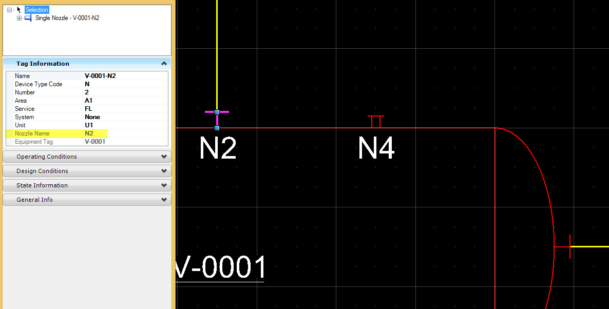

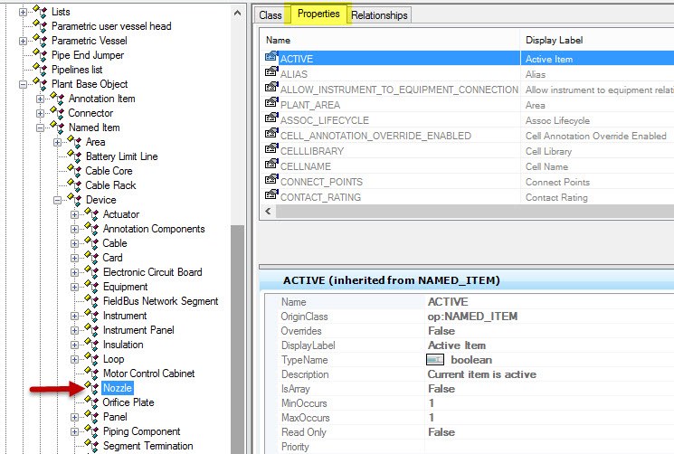

There is a requirement from user that when placing a nozzle on equipment, nozzle tag should be annotated which doesn't have equipment tag in it. For example, if nozzle tag is calculated as V-001-N1, only N1 should be annotated after placement.
  1. Launch class editor and load OpenPlant_PID schema.
  2. Supplement it with OpenPlant_PID_Supplemental_Imperial schema.
  3. Go to NOZZLE class and switch to Properties tab.

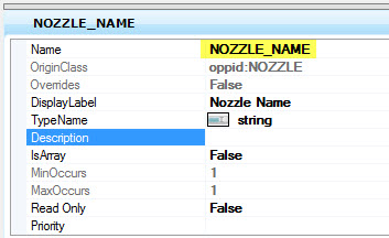

  4. Add new property and name it 'NOZZLE_NAME'.

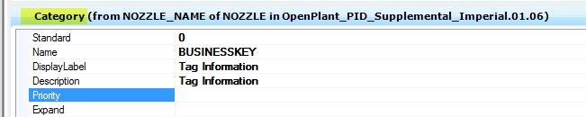

  5. Add Category custom attribute on it and key-in the values as shown below:

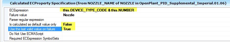

  6. Add another attribute 'Calculated ECProperty Specification' and add below expression.
    this.DEVICE_TYPE_CODE & this.NUMBER

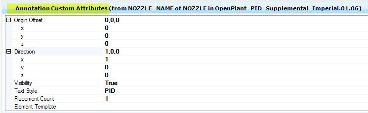

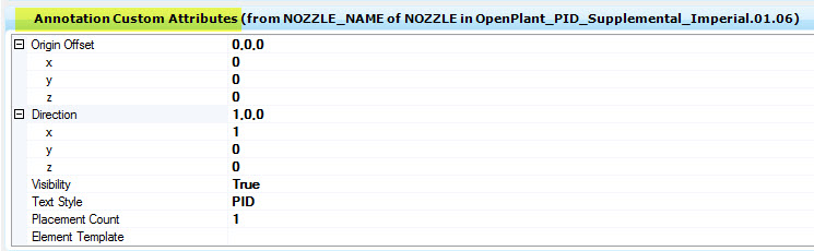

  7. Similarly add 'Annotation Custom Attribute' on it and set below values.
  8. Save the changes in schema and verify the result.
