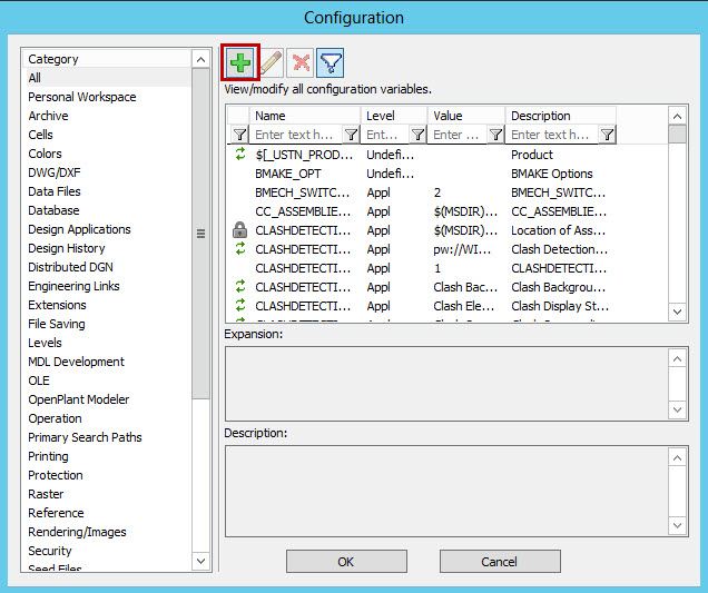

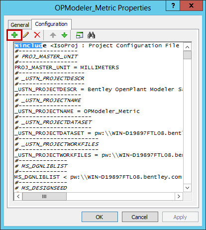

  2. Before connecting to OPMS repository, go to Workspace>Configuration.
  3. Click the add button as highlighted in below picture.

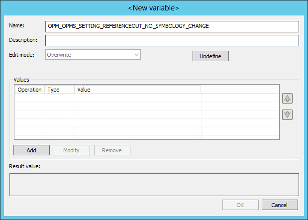

  4. Add the variable name in the dialog.

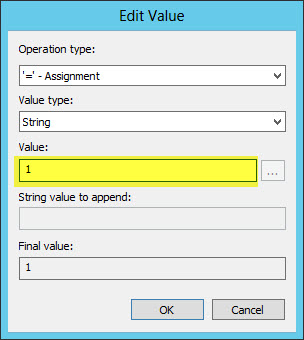

  5. Click the Add button in the same dialog and key-in the value as 1 in next dialog.
  6. Click OK in this dialog and subsequent dialog boxes to save the changes.

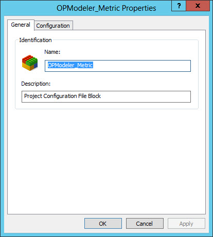

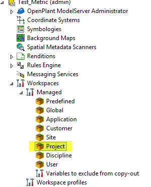

  1. Launch Projectwise Administrator.
  2. Go to Project Node in and double click on the project to open the properties dialog.
  3. Switch to Configuration tab and click ADD button.

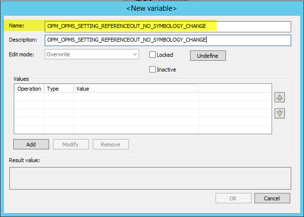

  4. Add the variable name and description as shown below.
  5. Click Add button on the same dialog and key-in the value in next dialog.
  6. Click OK on this dialog and subsequent dialogs to save the changes.

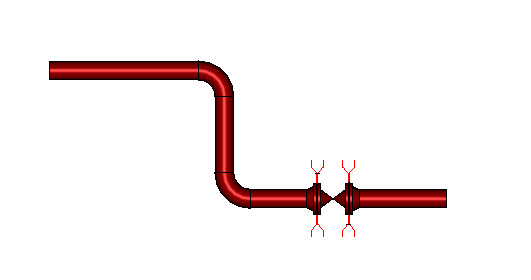

  1. Open a model and create a new Pipeline.
  2. Place few components and note the symbology.
  3. Check-in all the components into server.
  4. Now reference out the pipeline from server and check the symbology.
