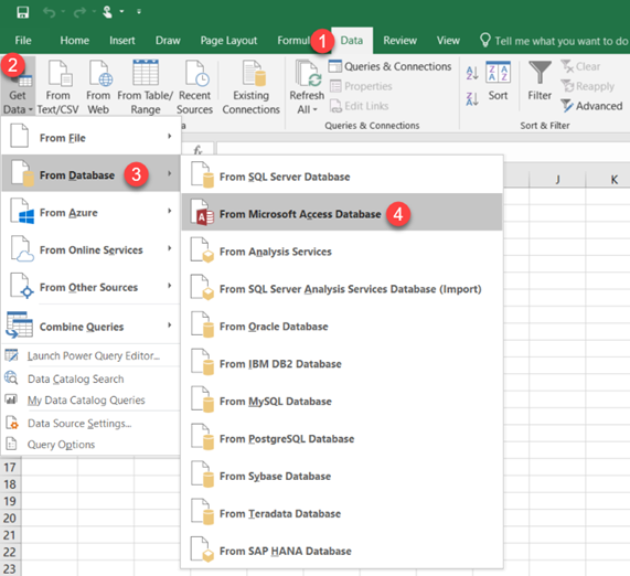

  1. Open Excel, click on data tab.
  2. Get data > from Database > from Access Database

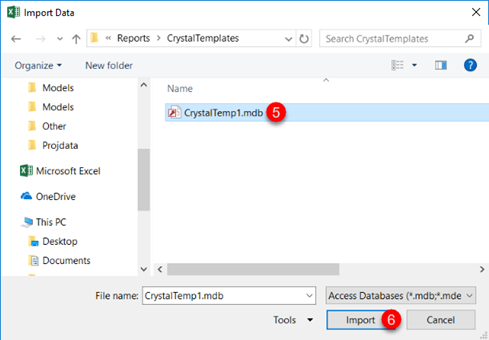

  3. Click on the file which you want to import

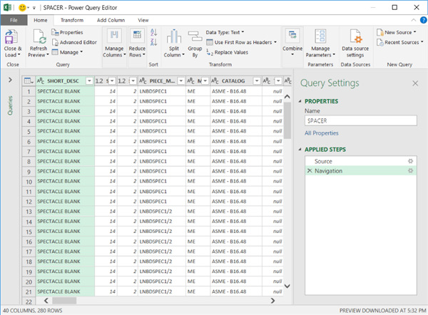

  4. Select the table and click on Load.
  5. Report is now ready for the print.
