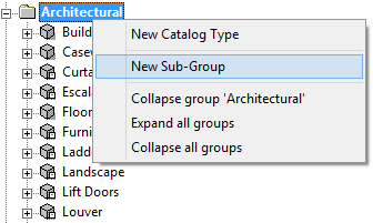

To create a new discipline sub-group, from within the DataGroup Catalog Editor right-click on the desired discipline name, select New Sub-Group, and enter a name.

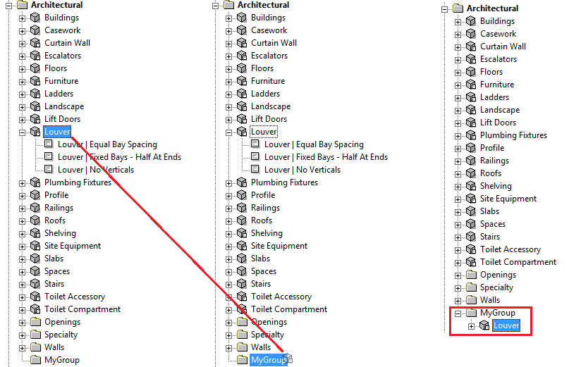

Then drag & drop the Catalog Types that you would like directly into your new Sub-Group folder.
Note: Because each Catalog Type can (and in most cases, will) have a different list of DataGroup properties associated with them, there is no interface for moving Catalog Items between Catalog Types.
