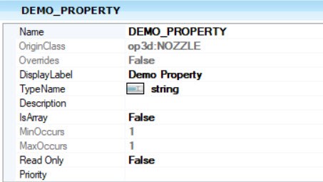

  4. Navigate to Nozzle class, switch to Properties tab.Refer image as shown below.
  5. Click on Add > New to create a new property.
  6. Enter property name as desired here “DEMO_PROPERTY” as shown below.
  7. Right click on created property select Custom Attributes > Add/Remove to add custom attribute. Refer image below
  8. Search Nozzle Property custom attribute & using drop arrow add to Applied Custom Attributes section. Refer image below
  9. Enter value as 30 (Maximum the value it will add property to end of nozzle manager dialog)
  10. Save all the changes & verify the result.
