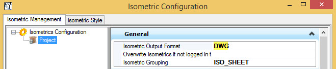

In OpenPlant Isometrics Manager, during isometrics generation it displays error as Error:[5] DWG creation failed.
Problem Description
In OpenPlant Isometrics Manager, when “Isometric Output Format” option selected as DWG like shown in below image.

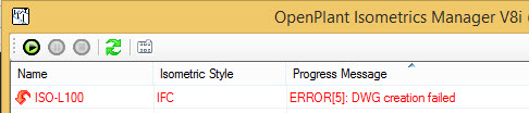

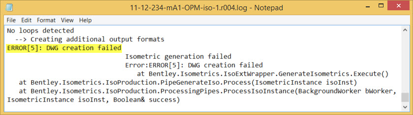

When user generates an isometrics then following error prompts as shown below.
Error:ERROR[5]: DWG creation failed
                                 at Bentley.Isometrics.IsoExtWrapper.GenerateIsometrics.Execute()
   at Bentley.Isometrics.IsoProduction.PipeGenerateIso.Process(IsometricInstance isoInst)
   at Bentley.Isometrics.IsoProduction.ProcessingPipes.ProcessIsoInstance(BackgroundWorker bWorker, IsometricInstance isoInst, Boolean& success)

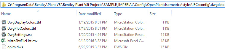

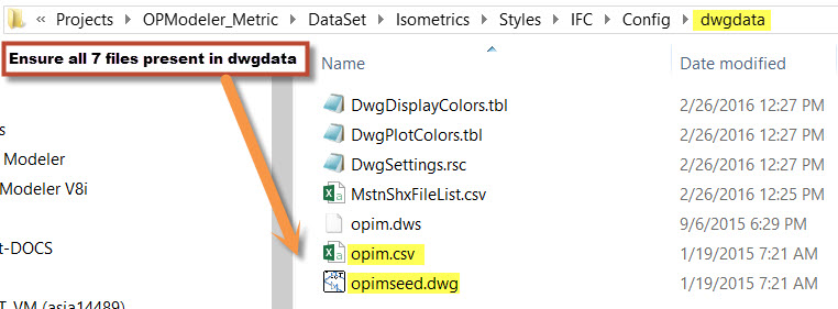

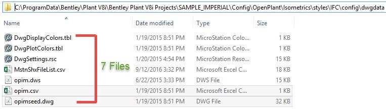

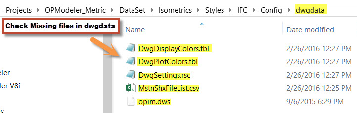

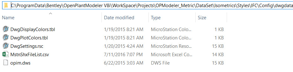

  1. The above errors mentioned due to missing file present inside the “dwgdata“ folder which is found under each styles for isometrics. See image below.

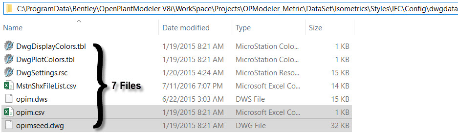

    Note - For default project - (C:\ProgramData\Bentley\OpenPlantModeler V8i\WorkSpace\Projects\OPModeler_Metric\DataSet\Isometrics\Styles\IFC)
  2. User has to check file defined inside the OpenPlant Modeler. See default dwgdata folder below where all files are present.

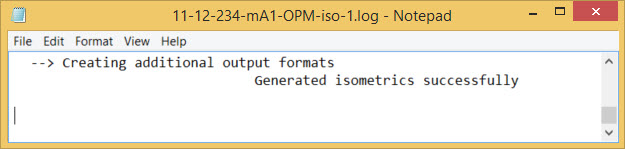

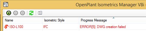

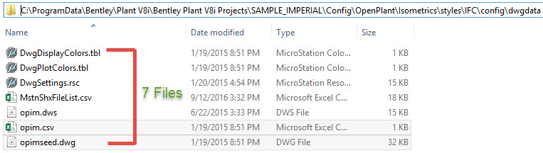

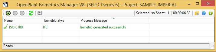

  3. Update the missing file to working style folder under “dwgdata” folder & verify results. See below image after putting all relevant files.
