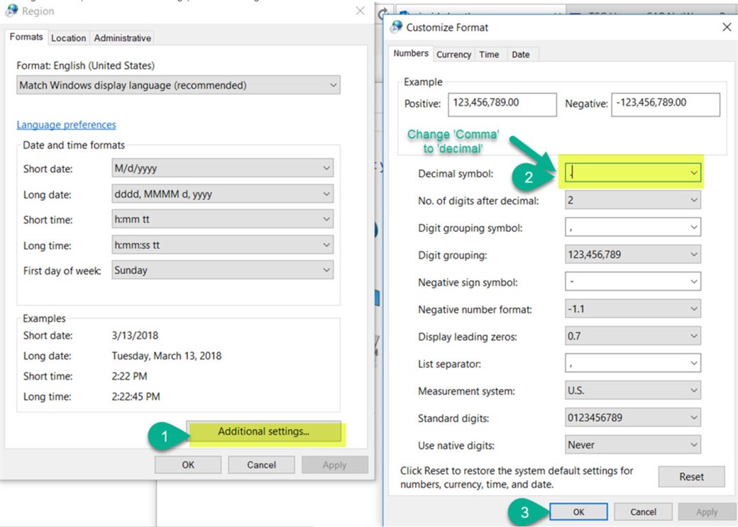

The above errors mentioned due to different regional settings. currently user need to change the regional settings from comma (,) to decimal (.).
  1. Change regional setting for comma to decimal for your system.
  2. Go to Control Panel > Change date, time, or number formats.
  3. From Region window, select Additional Settings, refer below image.

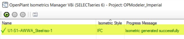

  4. Launch OpenPlant Modeler & verify results by generating isometrics using Pipeline Manager.
