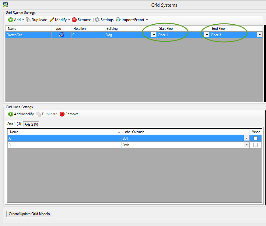

The axis doesn't always show on the 2D Drawing Model/Sheet Model. I have tried with many different settings and can't make groundfloor axis appear on the drawing. The axis on floors above do show so I guess it's not a problem with seed file. The problem seems to vanish on other computer. How can I fix it and do axis need to be turned on in 3d model to appear in the drawing? - after all it should depend on seed file settings.
Steps to Resolve
This could only happen if the floors on which the Sketch Grid (Axis) should display were not selected in the Grid Systems dialog box under "Start Floor" to "End Floor".  If the floors are selected before creating the grid models, the Sketch Grid (Axis) should display properly in the Drawing and Sheet Model.

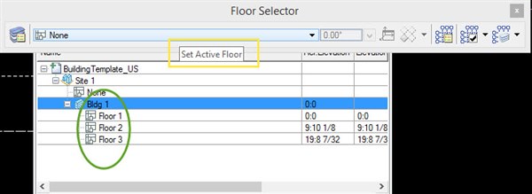

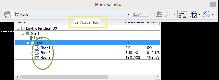

Also, make sure under Floor Selector the correct floor level is active before creating the Drawing View.
