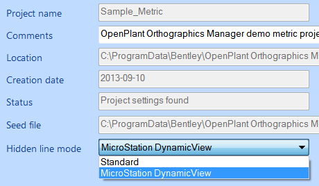

The steps below in wiki illustrate how to get Iso view in orthographic drawing. By default Hidden line mode is set to Standard in the Orthographics Manager project. Iso views can be attained by changing the mode to Microstation Dynamic view.
  1. Change the Hidden line mode to Microstation Dynamic view as below and click Save button

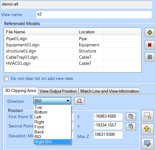

        2. Create a new view and change the Direction as below
        Note: In the pull down menu Iso views are also visible

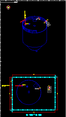

          3. Define appropriate position for the views and generate drawing to see the results
