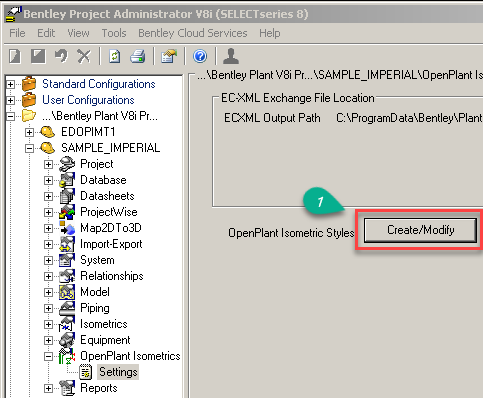

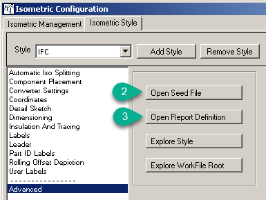

  1. Open Seed file and Report definition from required Projects Style folder or from OpenPlant Isometrics Manager Configuration dialog
  2. In report.def file create new Report for Bolt Stamp and save

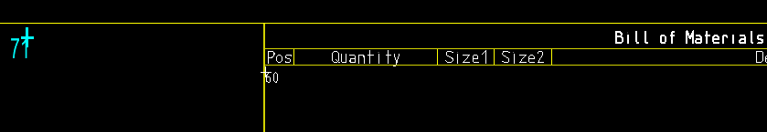

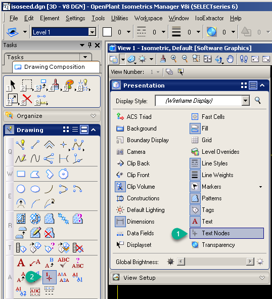

  3. In isoseed.dgn file enable to see placed Text Nodes and select to place new a new Text Node
  4. Place it on required location, disable Text Nodes visibility and close OpenPlant Isometric Manager.
  5. Now Generated required Isometrics model again and verify the results

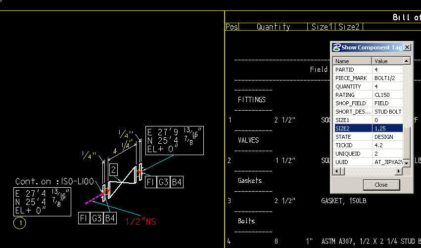

INCLUDE Size condition
There is requirement to place such stamp for bolts who are 1-1/4" and Larger and we can add additional rule to include only those bolt which are 1-1/14" or larger.
  1. Open Same report.def file and edit INLUDE line to add stamp only for isometric models which will contain EC_CLASS=BOLT equal or larger than 1 1/4"

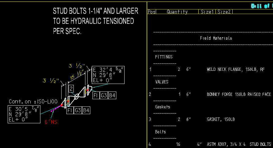

    # A STAMP for BOLTS
    REPORT = BOLT_STAMP
    INCLUDE = EC_CLASS=BOLT && SIZE2>1.25
    COLUMN = 10: W :
    TEXT = @   STUD BOLTS 1-1/4" AND LARGER
    TEXT = @   TO BE HYDRAULIC TENSIONED
    TEXT = @   PER SPEC.
    Write =
    NODE    = 71
    END
  2. Generate Isometrics of component containing smaller size bolts and Stamp wont be placed

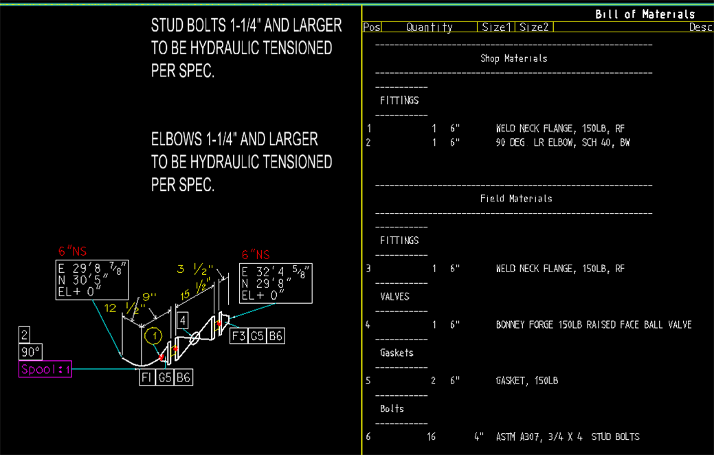

Include another Stamp
If model contains two type of special components than both stamps can be placed on same location. In order to achieve this a new report for new component type must be created and combined with previously created one.

  3. Create new report STAMPS
    # Combined BOLTS and ELBOWS stamps
    REPORT = STAMPS
       WRITE = BOLT_STAMP
       WRITE = ELBOW_STAMP
       NODE = 71
    END
  4. Generate Isometric which contains both component types and verify the results
