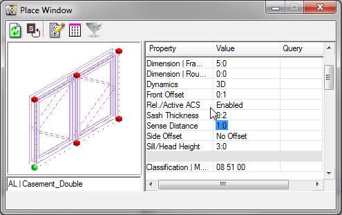

Problem Description
When placing a window in the model it perforates other walls beyond the wall where the window is placed.
Steps to Resolve
By default, the Sense Distance of the Window or Door should be 1.0.  Make sure that the sense distance is set to an appropriate value so that other walls wont be perforated at the time of placement.
