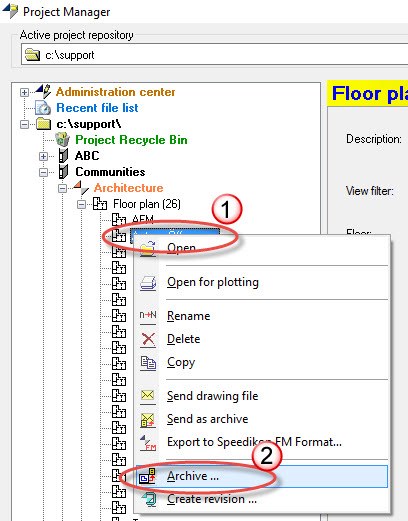

Open speedikon Project Manager
File - open

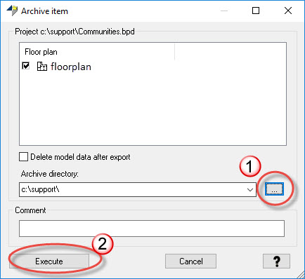

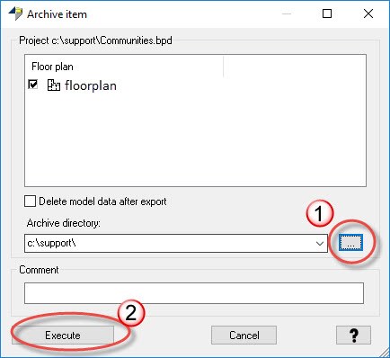

Right click a floorplan, section or drawing and choose Archive…
Choose a directory by using this Button
Choose „Execute“
After some seconds this box will appear.
Inside the Archive directory will be created now a *.smd file and a *.dgn file.
- The smd file includes all speedikon information
- The dgn file includes a graphical copy with no intelligence of speedikon.
But you can reference it for example.

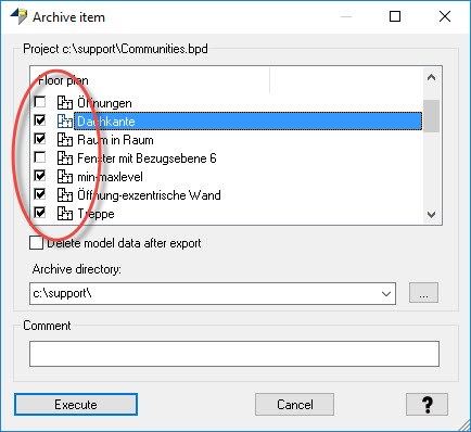

Alternatively, you can choose more than one file in one step.
Right click the Modul „Floor plan“, „Section/Elevation“, „Drawing“ or „3D-Construction“ and choose more than one file.

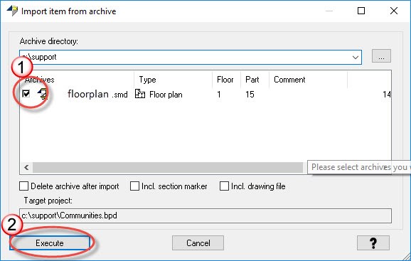

Import a smd file

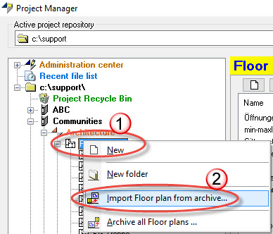

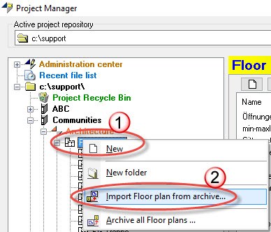

If you get a smd file you can import this file via speedikon Project Manager
Open the Project Manager
File - Open
Right click to you speedikon Project and choose „Import Floor plan from archive… “
Choose the directory where the smd file is located

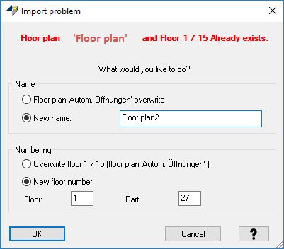

If there is a Floor plan, Section/Elevation or Drawings with the same Name you will get a Box.
„Import problem“. Now you have the possibility to overwrite or to choose another Name or Numbering.
Attention: You can not undo this step!
Note:
incl. section marker
If you like to archiv the section markers you can toggle this option and all section markers will be imported.
Attention:
If there is a section marker with the same number you will overwrite this section!
Incl. Drawing file
If you toggle this option, the graphic file will be imported in each case. This is only importent if you use speedikon for AutoCAD Workbase or/and MicroStation.
Delete archive after import
If you toggle this Option, the smd file will be deleted after the import. You can not undo this step.
Execute
The Import will be started.
Cancel
This will close the box.
