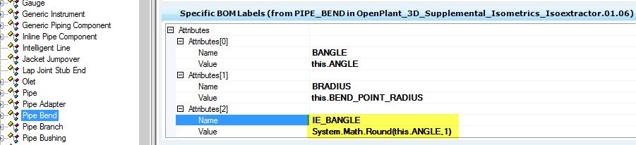

User wanted to display Bend Angle information with one value after decimal, rounding the values appears to be. Using the similar expression under "Specific BOM labels" custom attribute will aid user to achieve the desired settings. Below has been described in case of Pipe Bend class used while modeling and Angle associated with it.
  1. In Class Editor, Open ‘OpenPlant_3D_Supplemental_Isometrics_Isoextractor.01.04.ecschema.xml’ Schema.
  2. Navigate to desired class "PIPE_BEND".
  3. Check Custom Attrribute "Specific BOM Labels". Add Name and Value to it. See image below.
    Name - IE_BANGLE
    Value - System.Math.Round(this.ANGLE,1)
    Note - 0, 1, 2 is the precision value user can set to achieve. Also user may modify first attribute instead of creating a new entry(OPTIONAL).

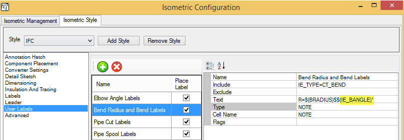

  4. Open Isometrics Configuration and modify labels like shown in below image. R=$(BRADIUS)$$(IE_BANGLE)°
  5. Save & Close the configuration dialog.

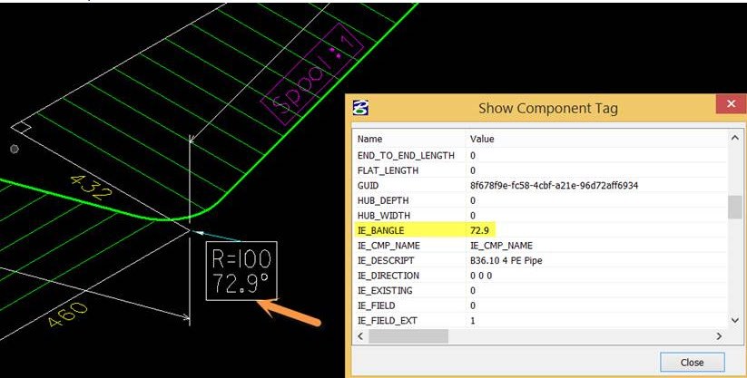

  6. Generate Isometrics & verify results.
