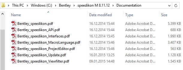

Where can I find the speedikon user manuals?
All manuals are delivered as a pdf with your installation.
- Bentley_speedikon.pdf                                   the basic user manual
- Bentley_speedikon_API.pdf                           about our COM-Interface
- Bentley_speedikon_Interfaces.pdf                 IFC, GBXML, STAAD.Pro, SDNF, sFM, HLI, PDS,…
- Bentley_speedikon_MacroLanguage.pdf       creating own speedikon elements, reports,…
- Bentley_speedikon_ProjectEditor.pdf            all speeedikon elements in table format
- Bentley_speedikon_Update.pdf                     What's new in this version
- Bentley_speedikon_Viewfilter.pdf                  modity the display of your elements

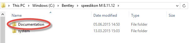

Please go to your installation path and have a look to the folder Documentation, e.g. C:\Bentley\speedikon M 8.11.12\Documentation\Bentley_speedikon.pdf

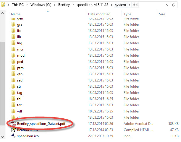

The manual about your installed dataset with its macros and libraries is stored in your system/std folder, e.g. C:\Bentley\speedikon M 8.11.12\system\std

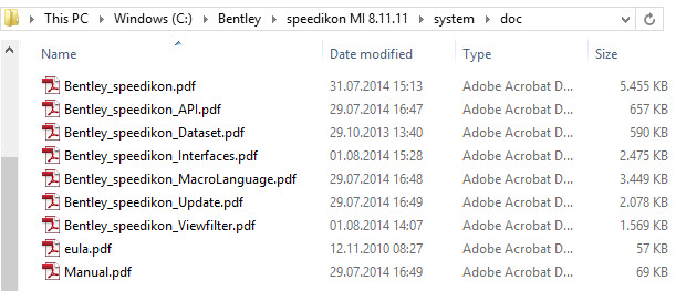

In previous versions, before speedikon V8i (SELECTseries 5), 08.11.12.09, the dataset manual is stored in the doc folder and you find this folder in your system, e.g. C:\Bentley\speedikon MI 8.11.11\system\doc
