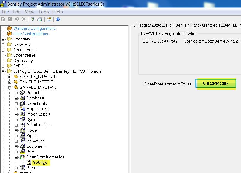

  1. Open Project Administrator and select working Project.
  2. Click on Create and modify button to launch OpenPlant Isometrics Manager Configuration dialog.

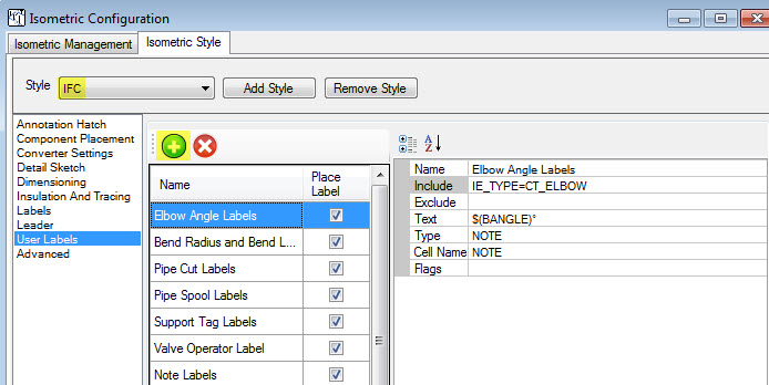

  3. Under "Isometrics Style" Tab click on User labels.

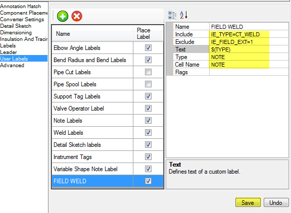

  4. Click on Plus "+" button to create a new User label.
  5. Add all fields like shown in below image.
  6. Generate isometric to review the result.
    Note: similarly we can define new label for other weld types field fit weld, Tack Field Weld. etc.

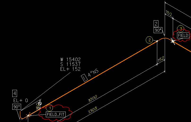

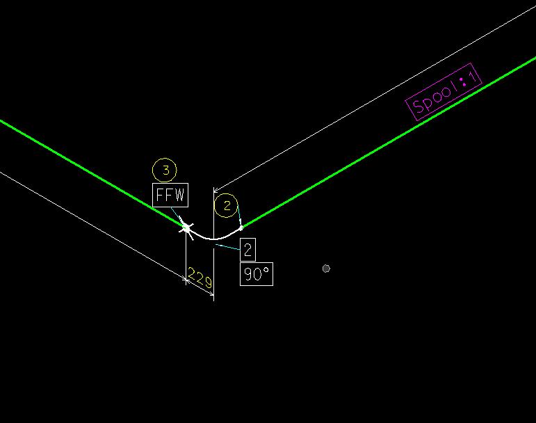

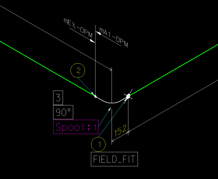

    If requirement have to show FIELD  as FW and FIELD_FIT as FFW  in isometric following additional steps need follow
  7. Open Class Editor
  8. Navigate to project path and open OpenPlant_3D.01.07.ecschema.xml
  9. And supplement with OpenPlant_3D_Supplemental_Isometrics_Isoextractor.01.07.ecschema.xml
  10. Go to Value map section search for Weld Types.
  11. Change property name FIELD_FIT to FFW and FIELD WELD to FW
