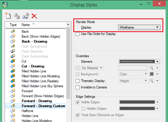

  1. Open your custom DrawingSeed DGNlib file and from the Display Styles dialog box create new Display Styles for the Cut and Forward wireframe representations as needed.  Close the Display Styles dialog box.

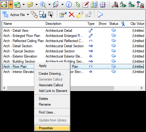

  2. Open the Saved Views dialog box.
  3. Right-click on the applicable Saved View and choose Properties from the pop-up menu.

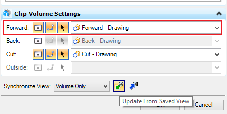

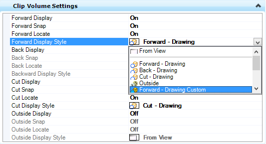

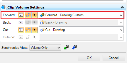

  4. From the Clip Volume Settings task panel click on the Cut Display Style, Forward Display Style and/or Back Display Style drop-down menus and choose your new Display Style(s). When finished close the Saved Views dialog box.
  5. Navigate to the Drawing Model associated to that Saved View that you've just changed, then right-click on any element and choose "Set Reference Presentation" from the pop-up menu.
  6. Click the green "Update From Saved View" button to pull in the changes you had made in step 4 then click OK.
