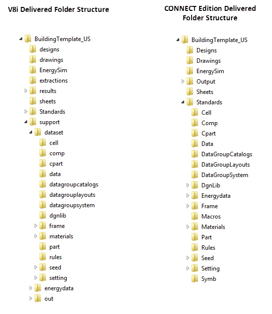

3. Apply CONNECT WorkSet folder changes:
In the CONNECT Edition, the folder structure and configuration variables were extended to accommodate user-definable standards at multiple levels throughout the Workspace/WorkSet organized into a shared standard folder.  In order to align with these folders and CONNECT configuration variables, it is necessary to redefine and restructure the Project "support" folder delivered in V8i.  This consist of the following folder structure changes:
 1. Rename the old "support" folder to "Standards"
 2. Move the contents in the "dataset" subdirectory  into the "Standards" folder and delete the now empty "dataset" subdirectory.
 3. Move the  "Energydata" subdirectory  into the "Standards" folder
 4. CONNECT Edition also add two new subdirectories to Standards, not previously available in V8i, ...\Standards\Macro and ...\Standards\Symb
 5. Move the "out"  subdirectory to the root of the Workset and rename to "Output" ( <WorkSetname>\Output)
 6. Move the "results" folder, used by Energy Services, and reside under "Output"
 7. The "extractions" folder was discontinued, with the deprecation of the Drawing Extraction Manager in the CONNECT Edition
 8. CONNECT Edition also applied Camel Case folder naming

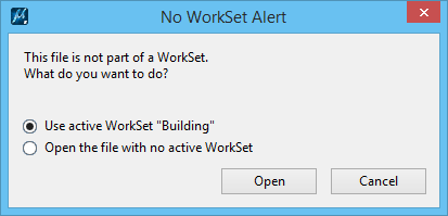

In the CONNECT Edition, all DGNs should be associated with (or belong to) a WorkSet. DGN files belonging to a WorkSet include WorkSet information or WorkSet properties. This enables you to place WorkSet properties as text fields and title blocks. This also notifies the users if they try to open a DGN from outside of the active WorkSet, helping the users maintain the data integrity of their DGNs. When you open a DGN file in a WorkSet, the CONNECT Edition checks if the file belongs to the active WorkSet, considering you just upgrade your v8i project to a CONNECT WorkSet, all you DGNs still remain unassociated and you will receive alerts to associate your file with the active WorkSet. In order to reduce the overhead of manually associating each file with the Active WorkSet, You can use "Batch Process" to automate the association.
You can associate an active WorkSet to multiple files using 'Batch Process' :
 1. Launch CONNECT Edition application
 2. Select Workspace>WorkSet - In the Welcome page, select the desired Workspace and WorkSet and open a file within that WorkSet.
 3. Acknowledge Alert - You should receive the following alert ( the this case the active WorkSet was "Building"). Since this should be the first time you are opening the file in the CONNECT Edition, the file your opening should be unassociated. With the default option to "Use active WorkSet…", select 'Open'

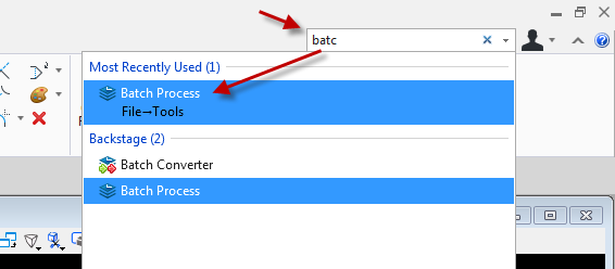

4. Locate and Open the 'Batch Process'  - To easily  locate the 'Batch Process' feature you can take advantage of the Ribbon Bar search option, by simply starting to type 'Batch Process' in search box in the upper right side of the Ribbon Bar (see below) or it can be accessed from the backstage under File>Tools.

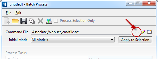

5. Browse for Command File -In the 'Batch Process'  dialog,  browse for the Associate_Workset_cmdfile.txt command file. By default, this command file should be delivered at …\Program Files\Bentley\AECOsim CONNECT Edition\AECOsimBuildingDesigner\Default\Data\.
This file contains two keyins:
  ○ FILE ASSOCIATEWORKSET   # Associate files to active WorkSet
  ○ FILEDESIGN SAVE SETTINGS   # Save Setting
