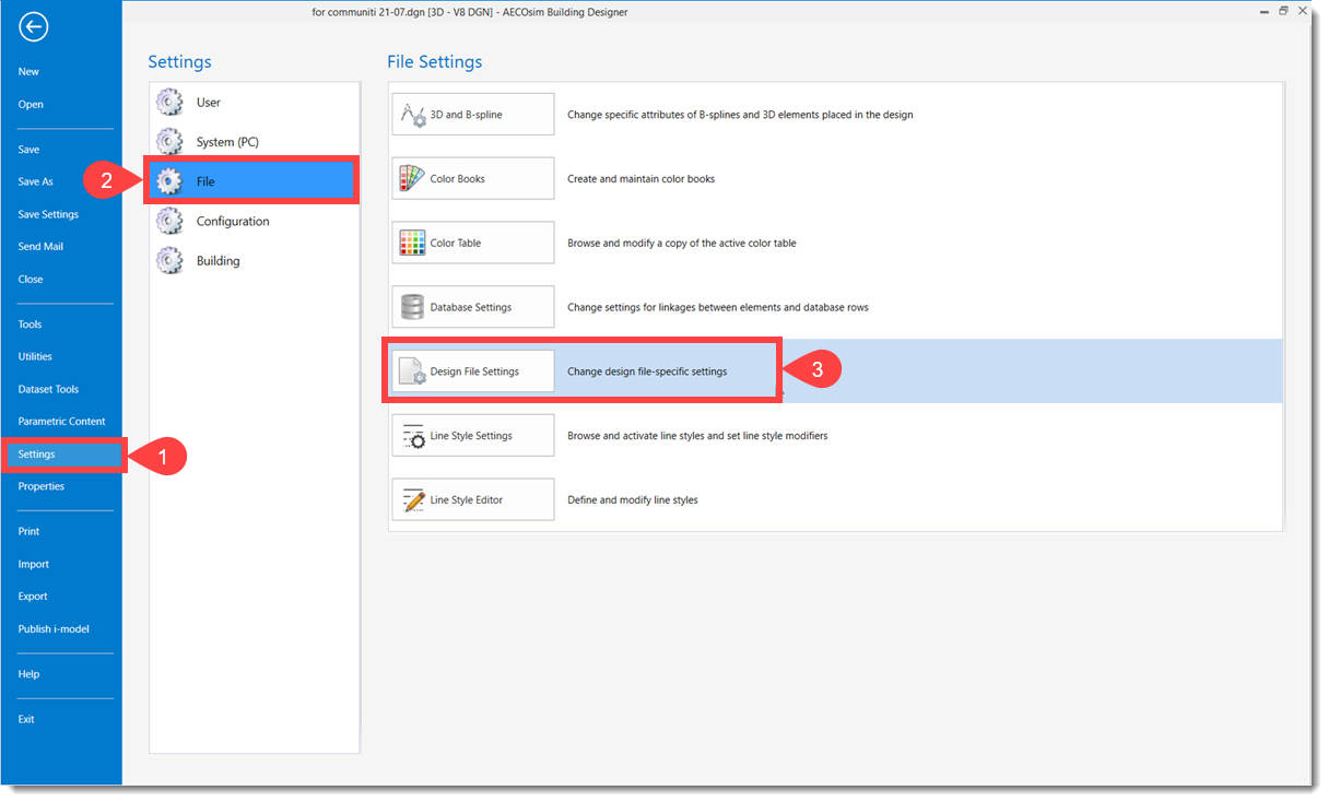

In default settings of AECOsim Building Designer Connect Edition, when you start working with US Dataset, you will find it has unit of Millimeter. If you need to change it, please go through the following steps.
- Click on 'File' menu on top left of screen. Then click on 'Settings', select 'File' settings tab and click on 'Design file Settings' option.

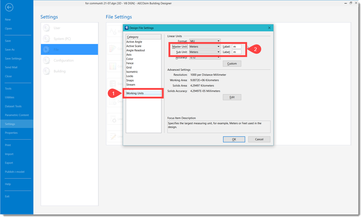

- A pop-up window will open. On left hand side, under category tab of that pop-up window, please select 'Working Units'. On right hand side, under 'Linear Units' , please change 'Master Unit' and 'Sub Unit' to your preferable unit from drop-down. e.g. Meters. Once done, click on 'OK' and go back to your work window.

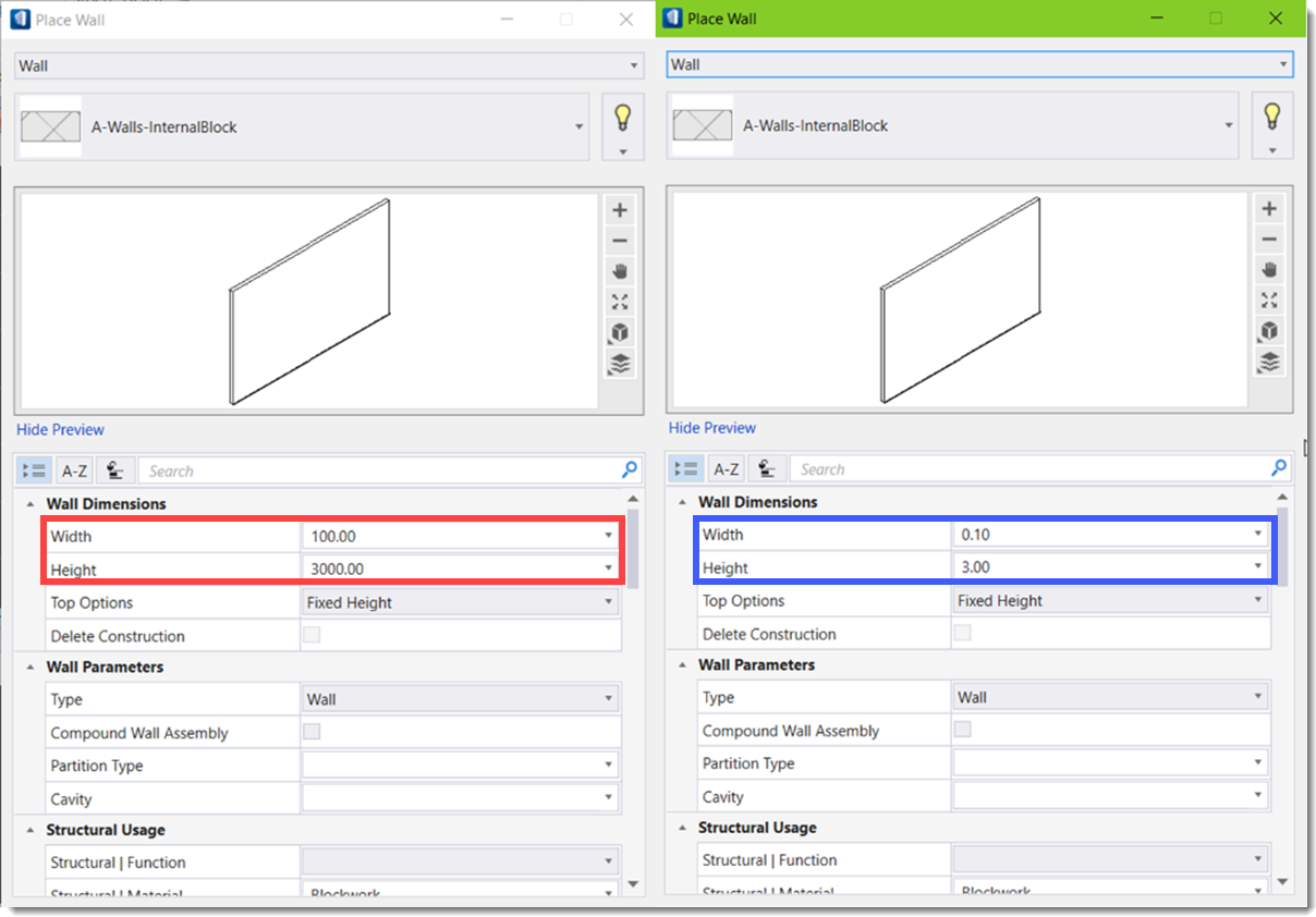

- You will be able to find that the working unit has been changed. From below image you can see that Millimeter Units (marked in red boundary) has changed to Meters (marked in blue boundary).
