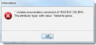

Error message is displayed when ‘Place Concrete Beam’ tool is used from the toolbox in AECOsim Building Designer integrated with ProjectWise. The same problem is not faced when working in offline mode.
"violates enumeration constraint of 'PAZ BXC CEL RFA'.
The attribute 'type' with value" failed to parse.

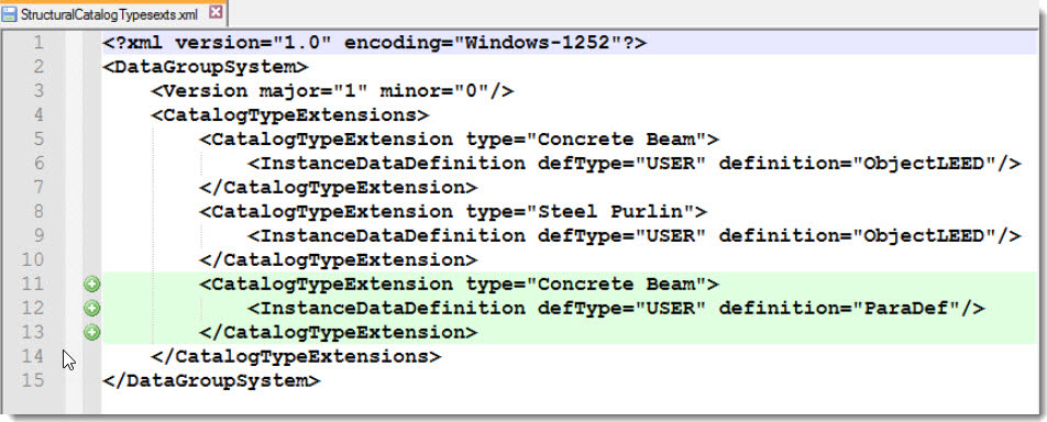

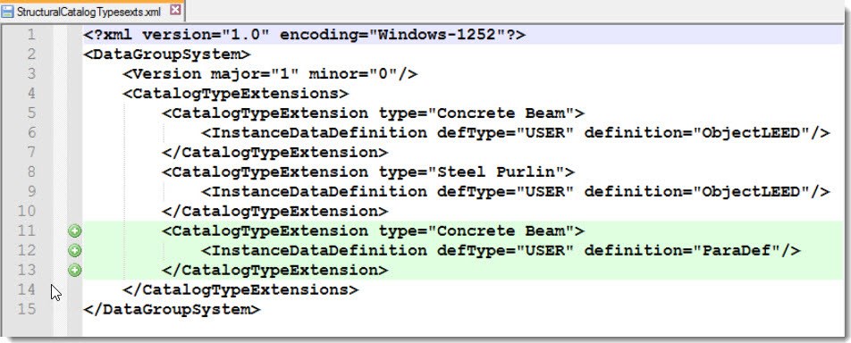

The image below shows ParaDef command in the ‘StructuralCatalogTypesexts.xml’ or ‘_Dataset_catalogtypeexts.xml’. The ParaDef definition isn't used by components that do not rely on cells, such as columns, so the tool itself (code) doesn't know what to do with it.

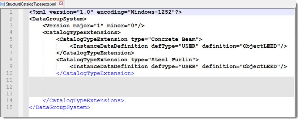

Just delete the ParaDef commands in the ‘StructuralCatalogTypesexts.xml’ or ‘_Dataset_catalogtypeexts.xml’ where the commands were present previously.
Refer image below for reference.
Now, when you try to ‘Place Concrete Beam’ tool from the toolbox, it will work perfectly in AECOsim Building Designer within ProjectWise.
