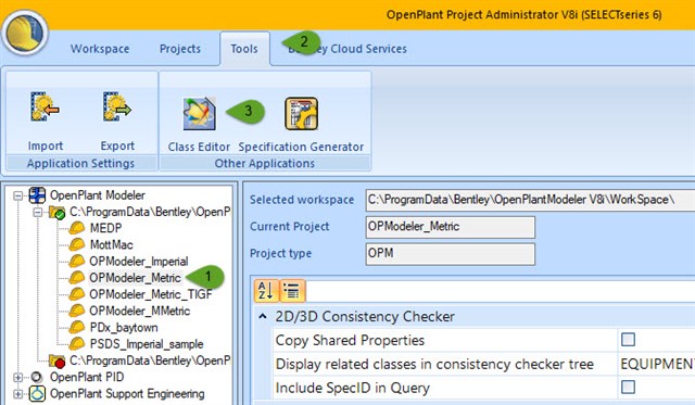

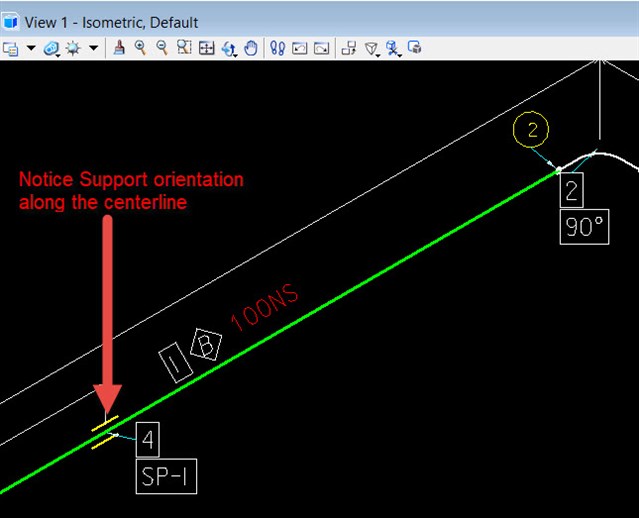

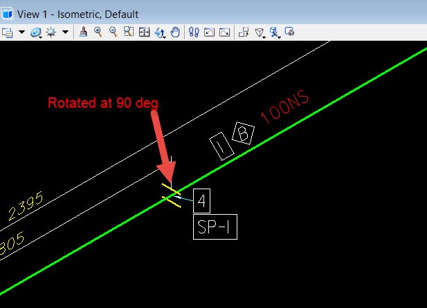

In OpenPlant Isometrics Manager, to rotate supports symbol as per requirement.
In OpenPlant Isometrics Manager, user wanted to rotate support orthogonally as per their project requirement. This can be achieved by editing isometric value map custom attribute inside schema through class editor. Below are the steps to illustrate the issue. Also see below image showing default orientation.
