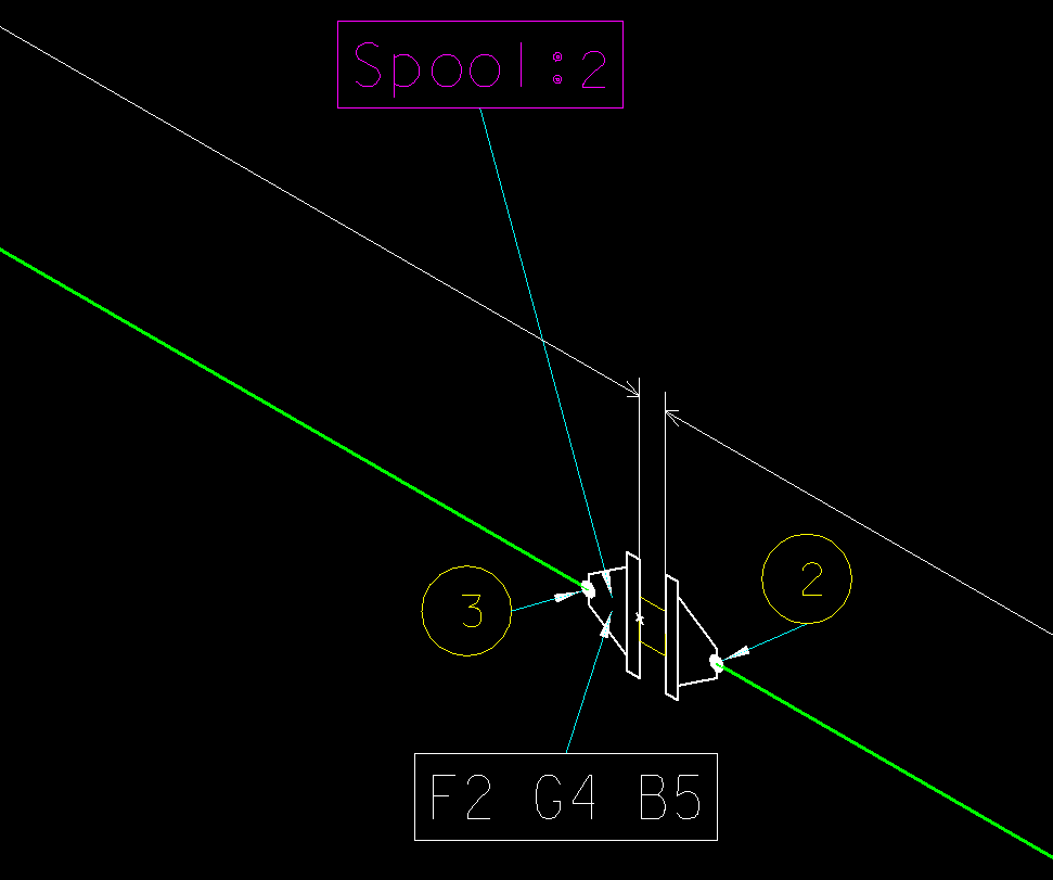

To use various option to display indexing for flanges bolts and Gaskets in OpenPlant Isometrics Manager.
In some project indexing is required to show in single bubble or Box for each component. See image below for default setup with latest OpenPlant Isometrics Manager version 08.11.11.101. to change various symbols and settings, see below steps for further help.

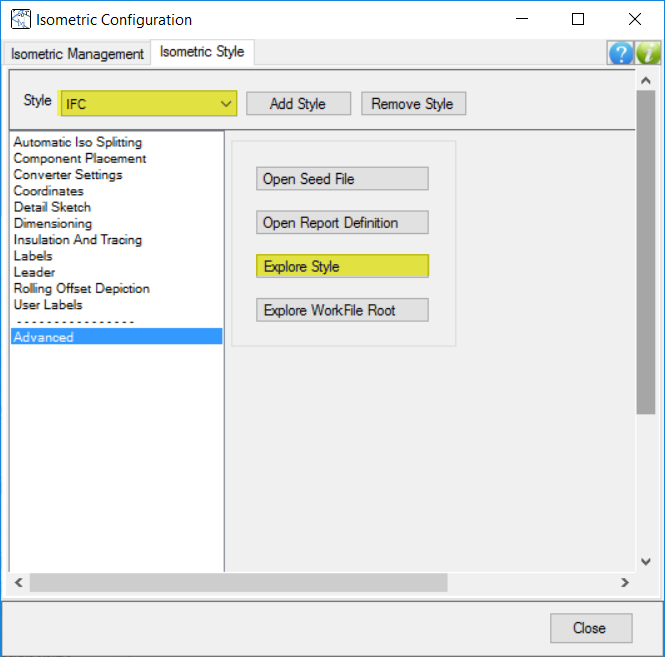

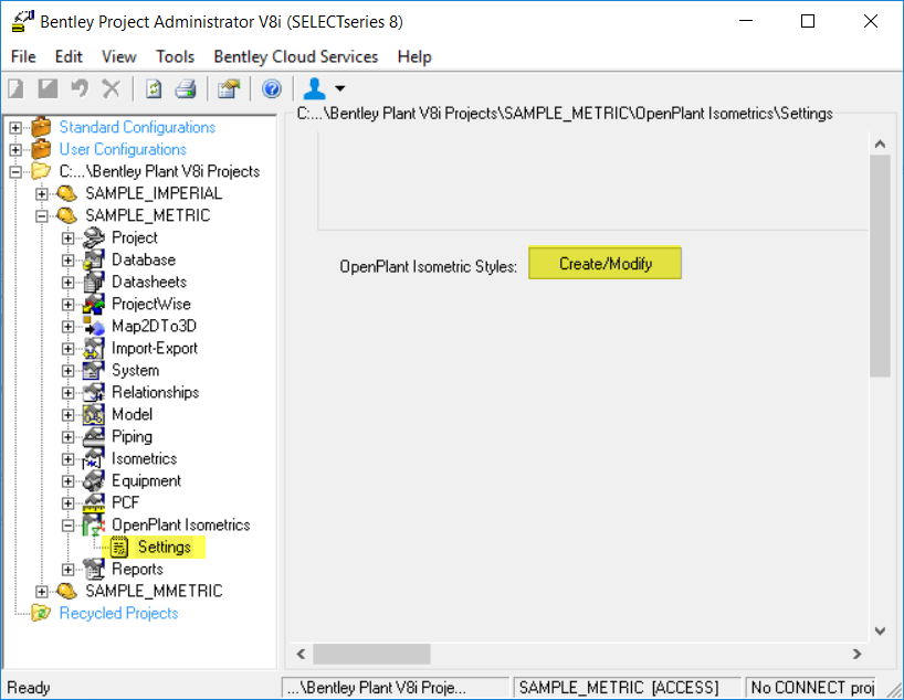

  1. Open "Isometric configuration" through Project Administrator.
  2. Select Settings option and click on "Create/Modify" option.
  3. In Isometric Configuration window select the desired Style.
  4.  Click on Advanced Option and select Explore Style.

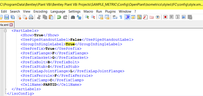

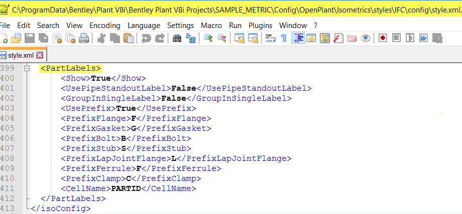

  5. In “config” folder, open style.xml file.

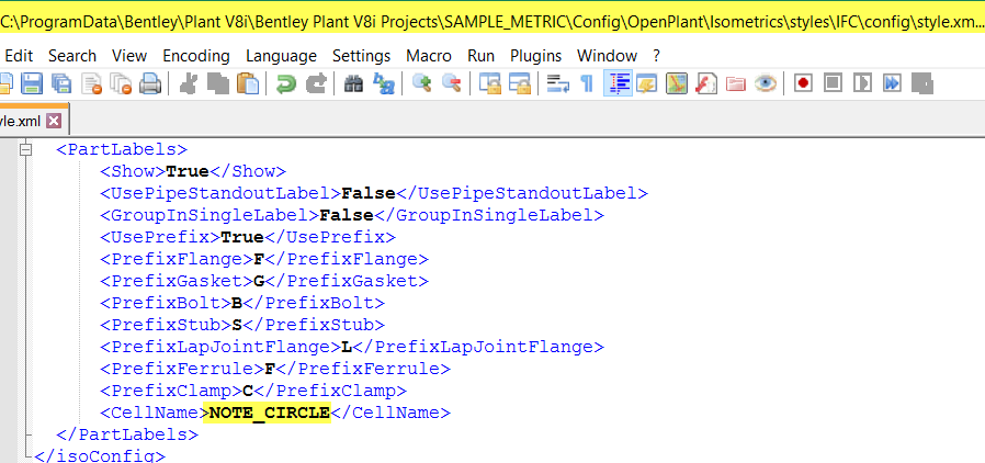

  6. Search for <PartLabels> and set various option as per requirement. Few of them are highlighted for reference. See image below.

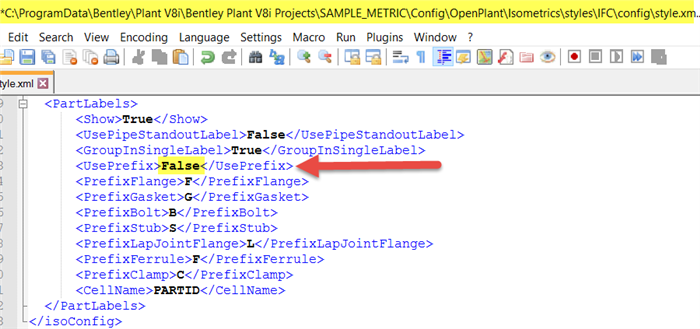

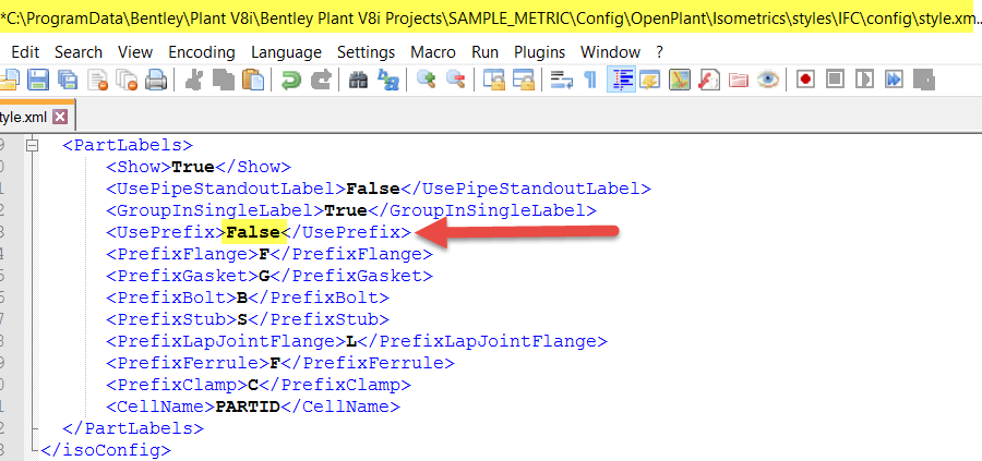

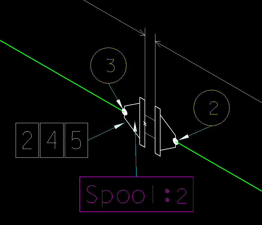

  7. To use labels without prefix -
    Set <UsePrefix>True</UsePrefix> to <UsePrefix>False</UsePrefix>. See image below. .

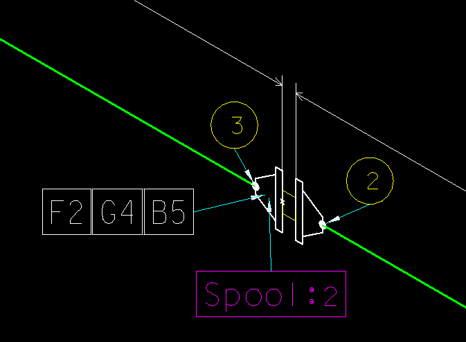

    See in Isometric:-

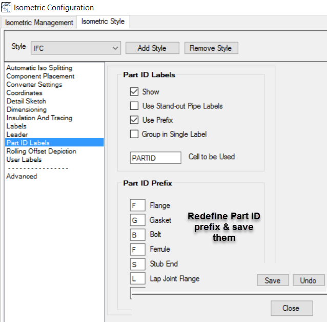

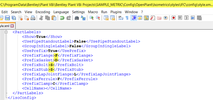

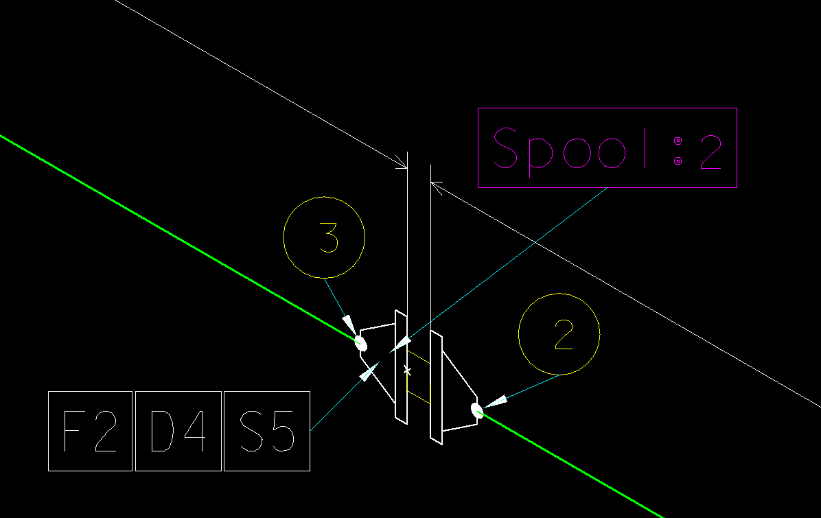

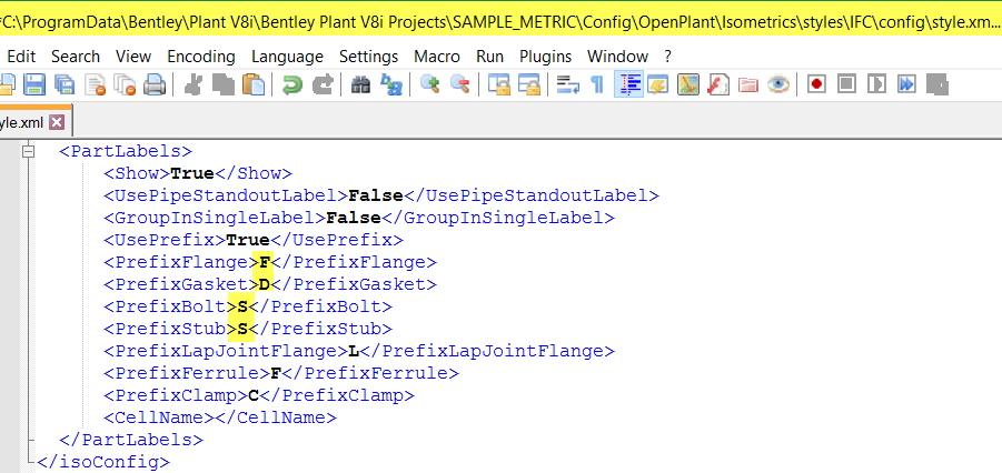

  8. To change prefix for regional use -
    (e.g in German it represents as F,D,S Flansch, Dichtung & Schrauben (Indexes F, D & S).
    Change settings as shown in below image.

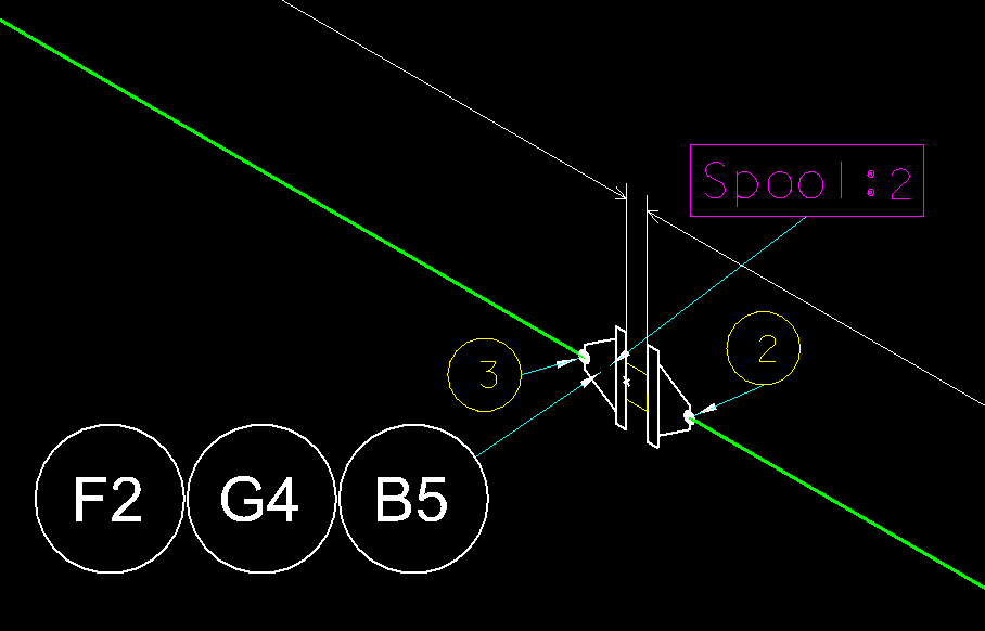

    See in Isometric
  9. To Change its bubble shape -
    Set Cell name NOTE_CIRCLE as shown in below image.
    See in Isometric

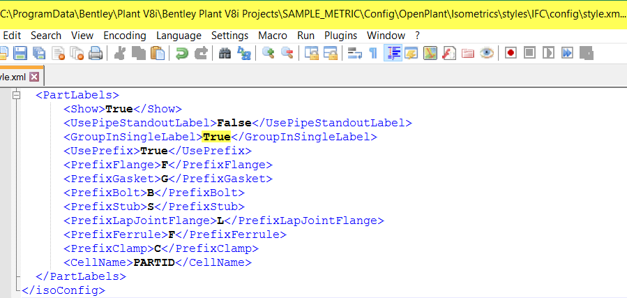

  10. To Consolidate Fastener Label in Single Box-
    Set GroupInSingleLabel as shown below.
    See in Isometric
