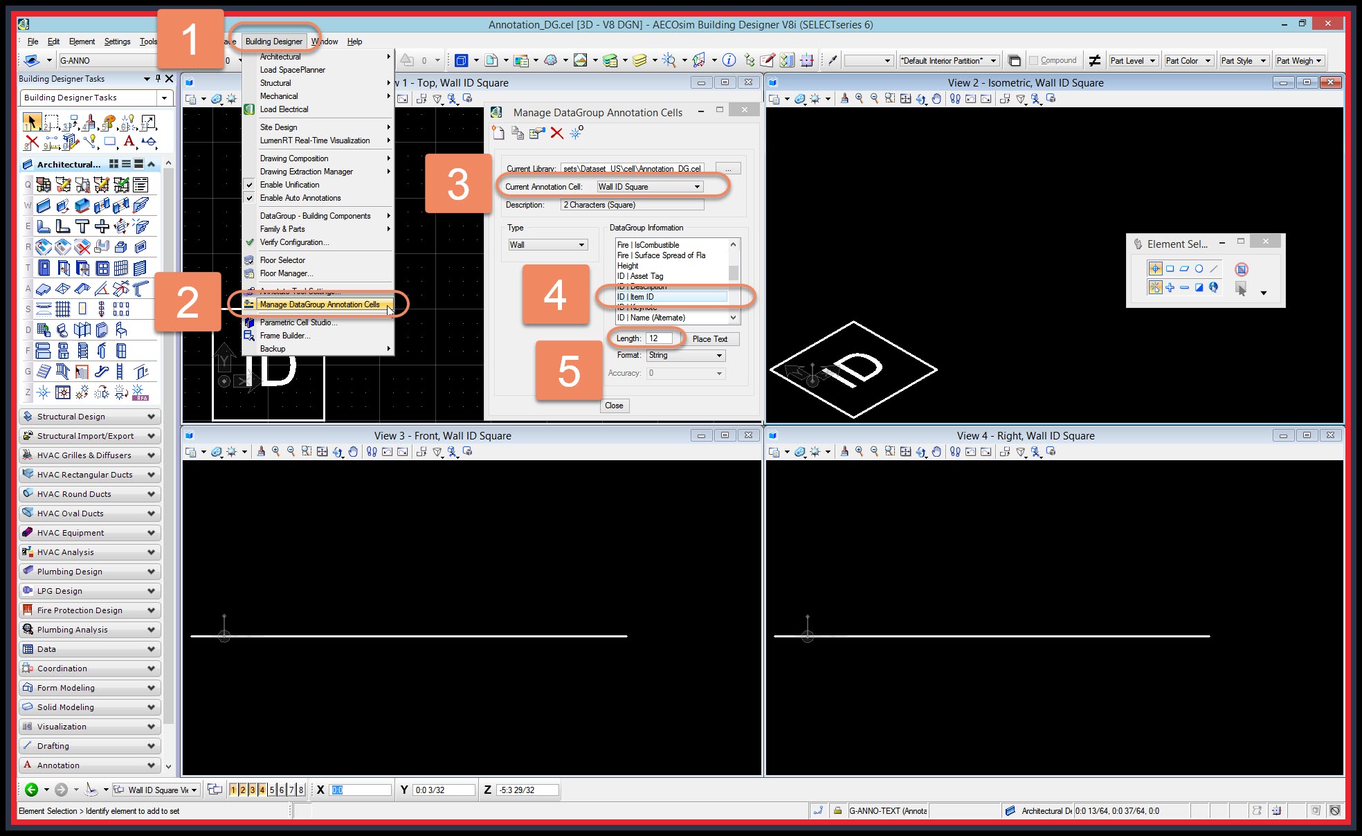

in V8i
![](82cd6f681bbd8690f3fc5287624bcbb5.iix)
- Click the Building Designer pull-down menu
- Click Manage DataGroup Annotation Cells
- Select the Annotation Cell you want to modify
- Select the DataGroup Information you want to use for the Label
- Set the Length value to the number of characters you want

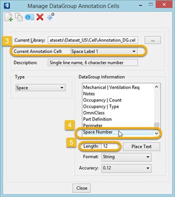

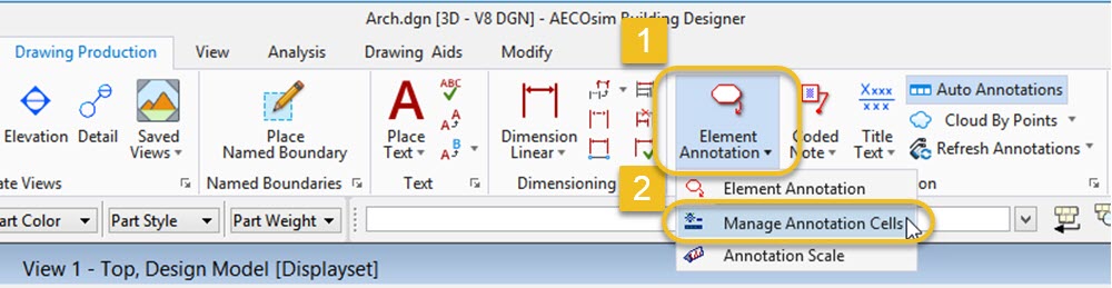

in CONNECT Edition
![](9ecd6f681bbd8690f3fc5287624bcbfc.iix)
![](aecdaf681bbd8690f3fc5287624bcb1b.iix)
- On the Drawing Production tab select the pull-down menu under Element Annotation and click Manage Annotation Cells
