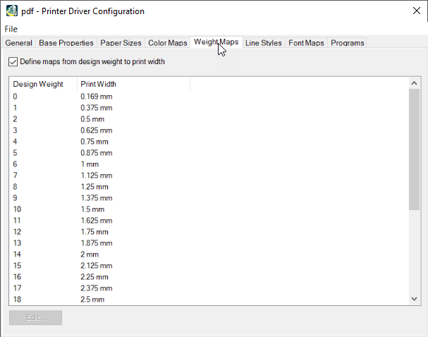

How do I control the line thickness that is assigned to a particular line weight while plotting? For example,  I select '6' as a cut thickness and I want it to be .5mm in line.

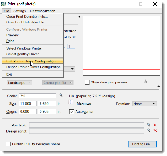

These are defined in the print/plot drivers.
In the Print dialog please go to the File menu > Edit Printer Driver Configuration.
Look at the Weight Maps tab.

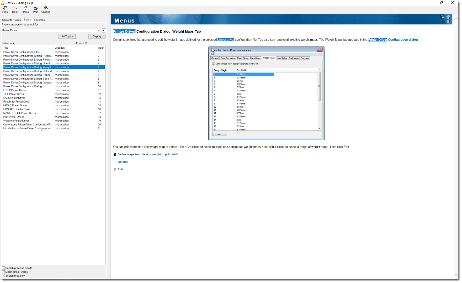

There is information on this in the help documentation under the heading "Printer Driver Configuration Dialog, Weight Maps Tab".
