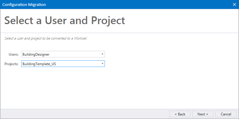

 5. On the Select a User and Project page, select user from the Users drop-down list and project from the Projects drop-down list.
 6. Click Next.

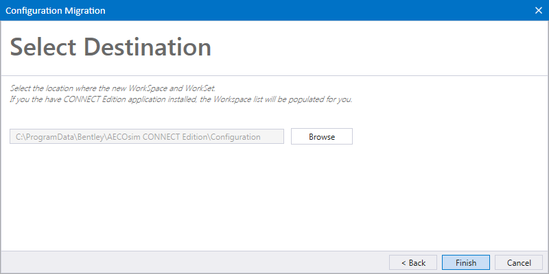

 7. Do one of the following:
To migrate to a new WorkSpace:
  a. Click the New WorkSpace radio button and optionally enter a new name of the new WorkSpace.
  b. (Optional) Enter new WorkSet name.
  c. Click Next.
  d. (Optional) To select a new location of the new WorkSpace and WorkSet, in the Select Destination page, click Browse. In the Select Custom Workspace path dialog that opens, navigate to the new folder and click Select Folder.
or
To migrate to an existing WorkSpace:
  e. Click the Existing WorkSpace radio button and select the desired WorkSpace from its drop-down list.
  f. (Optional) Enter new WorkSet name.
 8. Click Finish.
