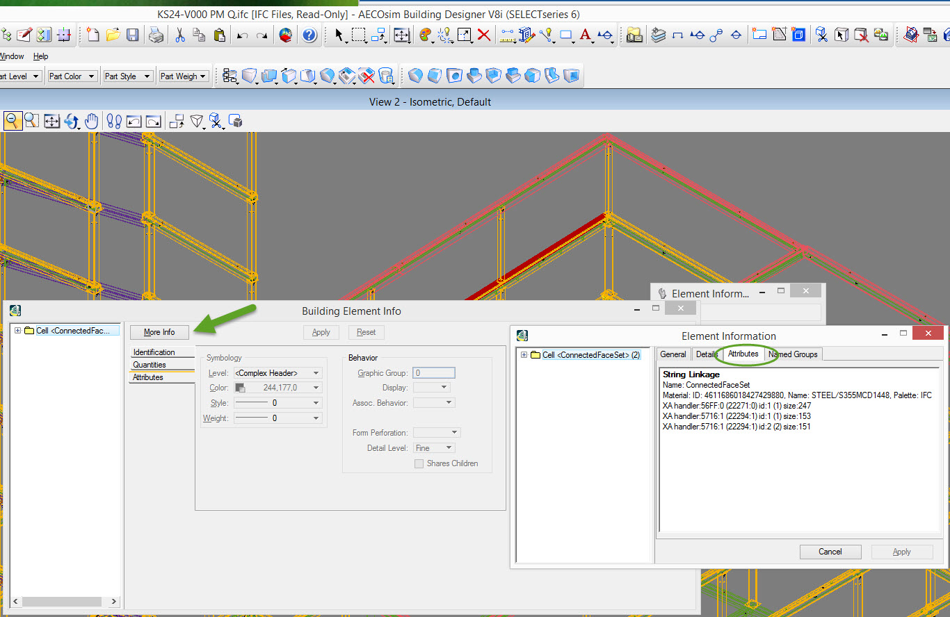

How to access the element's attributes in an IFC file?
Select the element of which you need the attributes information from,  Right Click > Building Element Information.  Select "More Info" and then select the Attribute tab:
