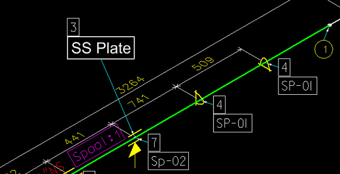

In OpenPlant Isometrics Manager, user requirement is to get Additional Material information in drawing as well as in BOM reports.

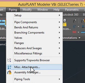

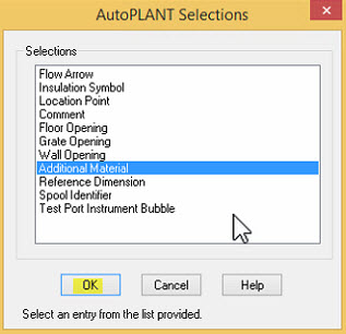

  1. In AutoPLANT Modeler, place additional material labels using Misc. Attachments. See images below.
  2. Click on Support modeled in a pipeline. Add description like shown in below image.
  3. Save & Close.

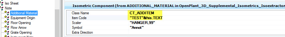

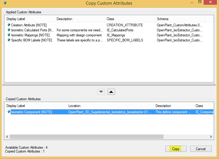

  7. On "ADDITIONAL_MATERIAL" class override the custom attribute "Isometric Component" to modify the class Name.

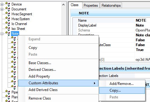

    1. To Override custom attribute "Isometric Component", user need to Add/Copy it from parent class, Say NOTE here.
    2. Navigate to NOTE class, right click on it ->Custom Attribute->Copy. See image below.

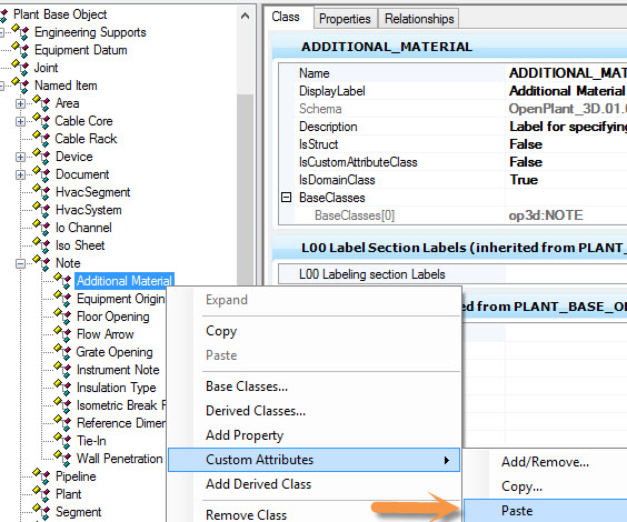

    3. Paste it to class "Additional Material". See image below.
    4. Now it will be able to modify the content inside the custom attribute.
  8. Change Class name from default "CT_NOTE" to "CT_ADDITEM". Also change Item code to "TEST" & this.TEXT. See image below.

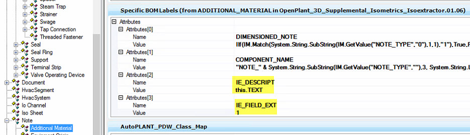

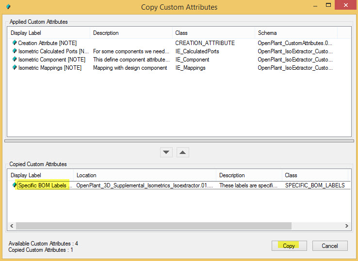

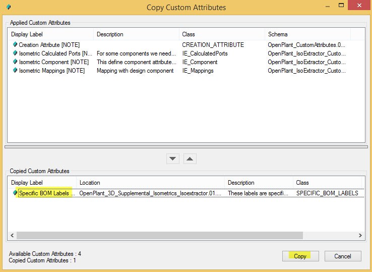

  9. Similarly Override another custom attribute "Specific BOM Labels" like shown under step 4 above.
    1. To Override custom attribute "Specific BOM Labels", user need to Add/Copy it from parent class, Say NOTE here.

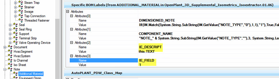

  10. Add attributes "IE_DESCRIPT" & "IE_FIELD" like shown in below image.
    Note - Above attribute has been added to get the information available on isometric BOM and under specific Shop/Field Category.

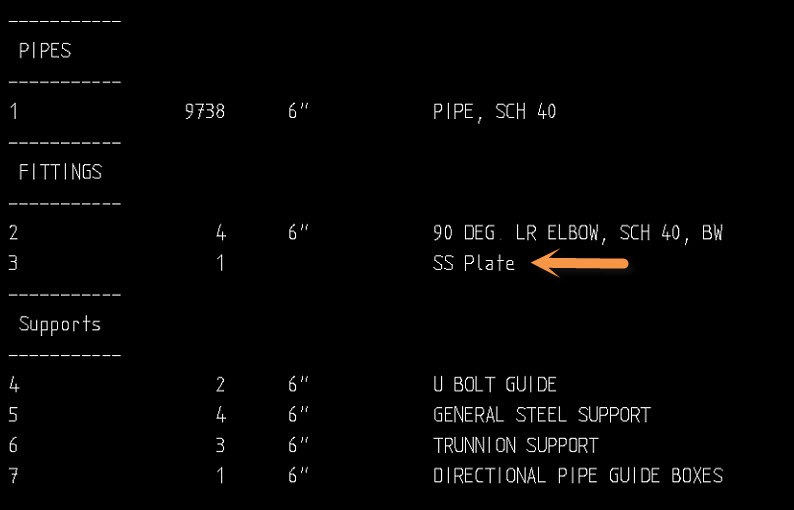

  12. Launch OpenPlant Isometrics Manager & verify results. See image below.
  13. Also Check Bill OF materials section.
