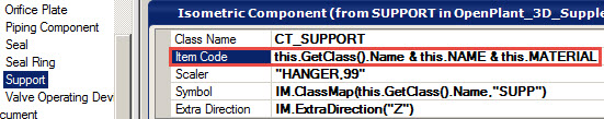

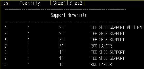

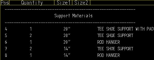

In OpenPlant Isometrics Manager, user wanted to group support based on EC Class Name irrespective of different support Sizes. In order to achieve the desired setting, it should also display common PARTID for grouped support Class. With default configuration, see below BOM.

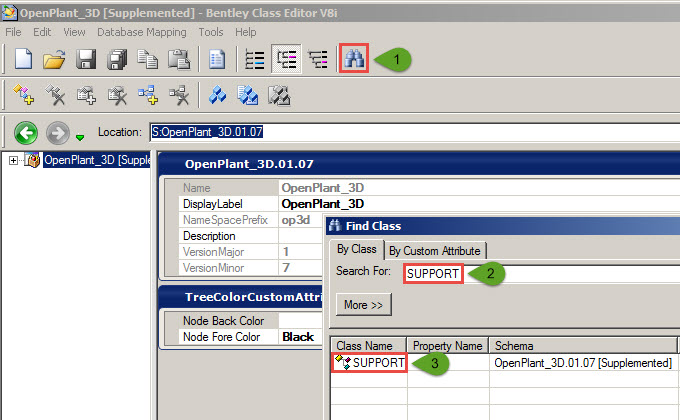

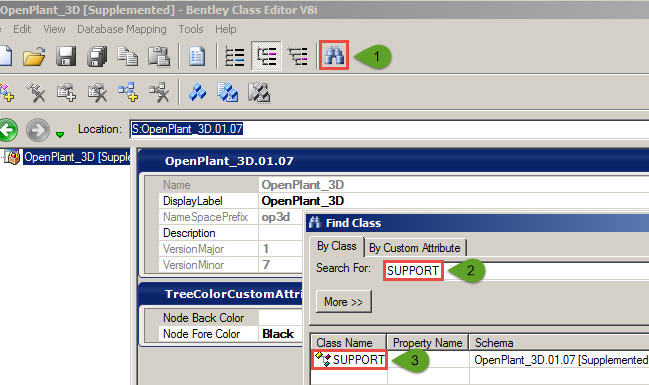

  1. In Class Editor, open “OpenPlant_3D.01.07.ecschema” & Supplement it with “OpenPlant_3D_Supplemental_Isometrics_Isoextractor.01.07.ecschema”
  2. Navigate to SUPPORT class using Search.

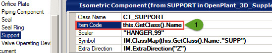

  3. Check custom attribute "Isometric Component",
    & define the Item code field as this.GetClass().Name
    NoteTo override the custom attribute and allow it for further modification, you can copy it from other class which has an entry for it.

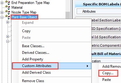

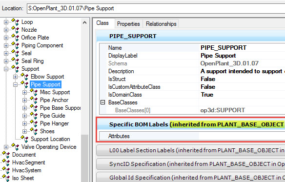

  1. Navigate to PIPE_SUPPORT class and check Specific BOM Labels custom attribute.
  2. Specific BOM Label custom attribute is empty and inherited from PLANT_BASE_OBJECT class, so the easiest way to add this custom attribute is by copying it from this class.

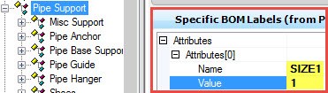

  3. Right-Click Pipe Support class and Paste copied custom attribute. In this custom attribute right-click on Attributes line and add new element.
  4. Then under custom attribute “Specific BOM Labels” add Name as SIZE1 & value as 1, as shown in image below.

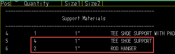

  5. Generate isometrics and verify results. See below image.
