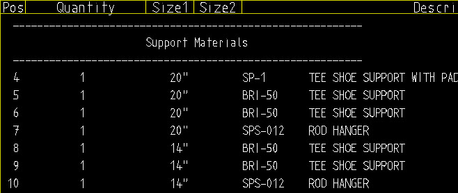

In OpenPlant Isometrics Manager, user wanted to group common support tag name irrespective of different support type. In order to achieve the desired setting, it should also display common PARTID for grouped support tags. For Example different Support classes contains different tag names, which generates different PARTID. User requirement is to have same PARTID for similar tag name.

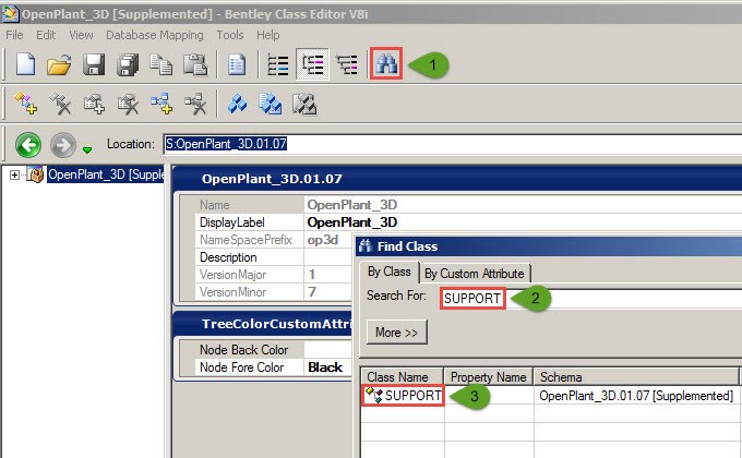

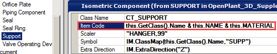

  1. In Class Editor, open OpenPlant_3D.01.07.ecschema & Supplement it with OpenPlant_3D_Supplemental_Isometrics_Isoextractor.01.07.ecschema
  2. Navigate to SUPPORT class using Search.

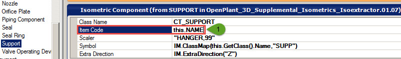

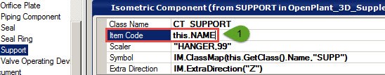

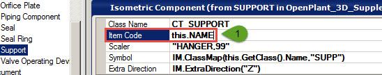

  3. Check custom attribute "Isometric Component",
    & define the Item code field as this.NAME. See image below.
  4. Save & Close Schema.

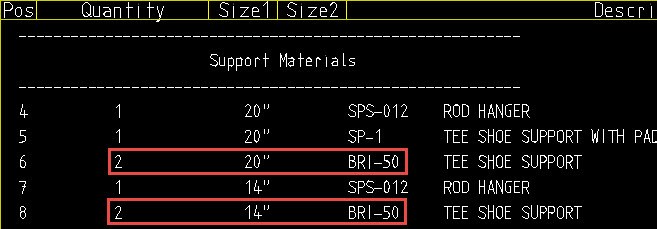

  10. Generate ISO’s and verify results. See image below.
