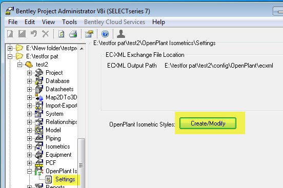

  1. Open "Isometric configuration" through Project Administrator.
  2. Select Settings option and click on "Create/Modify" option.

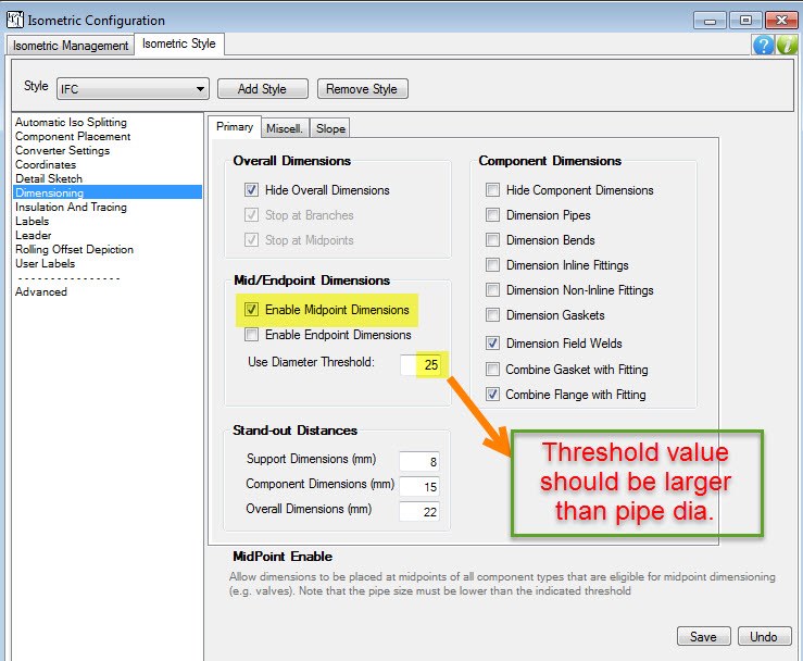

  3. Use "Dimensioning" option from Index present in Isometric Configuration dialog.
  4. Under "Primary" tab, go to option Mid/Endpoint Dimensions & check ON “Enable Midpoint Dimensions”.
  5. Click on “Save”.

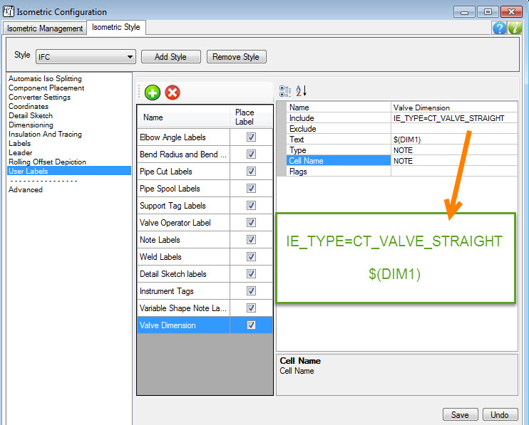

  6. Create new User Label “Valve Dimension”.
    Include    IE_TYPE=CT_VALVE_STRAIGHT
    Text   $(DIM1)
    Type   NOTE
    Cell Name   NOTE
  7. Click “Save”.

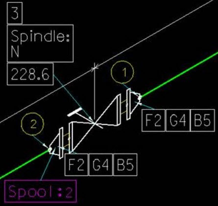

  8. Generate isometric to review the result.
